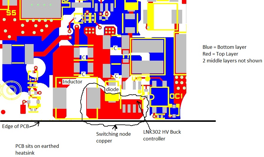

Please help us to pass conducted emissions of EMC testing, particularly with reference to common mode noise created by the switching node of our 1W Buck converter
We have a 1W Buck converter (bias supply) on our offline 150W LED driver PCB (which uses linear current regulators).
It firstly failed EMC due to having the Buck’s switching node copper layed out all over the bottom PCB layer, where it was next to the earthed heatsink. (common mode emissions).
We now have removed the switching node copper from the bottom layer. However, do you believe that we should shield the switching node copper (which is now only on the top layer) from the earthed heatsink by putting some “quiet node” copper underneath the switching node of the Buck, in order to shield the switching node from the earthed heatsink on which the PCB sits?
(eg we could put the “quiet node copper” on middle and bottom layers of the 4 layer board. The switching node copper is now only on the top layer. The PCB sits on a thin thermal pad which is on the earthed heatsink)
Yes, the capacitive coupling from the switching transistor and nodes should be minimized as much as possible from the earthed heatsink.
A ground plane should significantly reduce that coupling.
Thanks, some say though that the switching node could induce noise into the ground plane if the ground plane is directly beneath the switching node?

Hello,
Attached please find the PCB area containing the HV DC Buck converter and the switching node.
I wonder if it would be worth adding a small “metal box” kind of like a tent (a shield) above the switching node copper, the inductor and diode? Maybe this would stop the radiation from eminating out from the switching node and going into the earthed heatsink? We could solder the box to a quiet node on the PCB?
This would reduce common mode emissions?

Would a shielded inductor be probable? Or is that type all ready in use?
Or an non shielded type?
As for the shield (the "metal box" ) that sets close or at the switching node area would be based on at least 2 factors of concern, 1 I doubt the current switch noise would be too great to flood the added metallic component (depending of material) and cause problems, however, be careful that the add on part in size does not ( for the better term I can use that fits close to what I'm trying to say) The term "saturate" and produce an antenna like effect to the surrounding area (this should not happen unless large startup spikes are possible). That is unless the shield would be non conductive at its uppermost top and sides (coated) and only the bottom plate exposed and the soldered point for conduct. Or be greatly adequate at allowing the flow to the quiet plane on the board enough to not need concern about coating the shield at all.
2. And that the shield does not reflect back causing amplification of noise.
: Edit : add in the term, reactance.
Most point, that added shield would reduce noise as long as the out is directed towards the PCB input common or large enough plane area that can accept and result in an ignore the noise ( it has little to no problem accepting the noise) value.

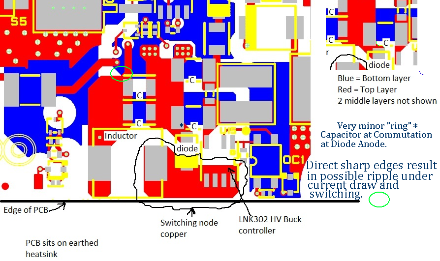

Do not see a ferrite solution on that a compact space, however if possible to round out the trace a tad located by the what should be the larger value 2nd capacitor above the inductor on the output side onto the plug via to one of the innermost layers. (added an image below showing 2 areas only focusing at the inductor) and commutation diode anode. The minor issue at the commutation diode could be ignored as it would not be an at all times issue, start ups and shutdowns and unstable power inputs from grid that rate a major drop in power or ramp that might affect the switch.
Any MOV type device would handle the ramp up from grid as will an ICL at main input.
That's just the thing with inductors, that both sides are not an absolute value when switched adequately, I'm referring to the inductor out, if there is a returned "ripple" effect the inductor core would be strongest at what value it is being charged to so to speak, and the nano and uF range capacitors are to stabilize the voltage to a percent on the inductor output, if the output has a chance to back feed, the voltage can begin to fluctuate enhancing ripple and show itself at the switching side in a minor sense as there can be a delay before the switch in sinking mode would see this, all ready changing to source mode causing a minor collision at the inductors input from switch causing an odd ramping voltage noise.
Some affects that have this issue tend to adjust the value of inductor to try and match this return ripple and create a matching or close to collision at inductors output that the capacitors absorb the unwanted value when a board design encounters this issue rather than a complete or possible need to redesign the PCB if the problem is too fast for a capacitor (term rare). Other directions to take are on the capacitors ESR rating can alter things considerably. Tho that can be tasking to find an reasonable value and whilst compensating for temperature if that is a requirement, minor core changes with temperature that can take that effort to find that best placement of value and just thrash it by a few points in either direction of temperature resulting in a no longer adequate setting.

I have to ask, is there any voltage, let say close to a few hundred mV at the switching IC's common pin when circuit is operating? Possibly near 700 or so mV?
I see. Opto driven of BP pin to FB voltage ramp to dividend resistor at desired voltage after inductor resulting in blocking of voltage forward of Opto IR with a zener to take possible reverse flow away from the opto IR to common with a current limit resistor for zener at the Opto cathode.
BP capacitor can produce minor noise. That looks plenty isolated on the board design.
Even with a switch as that, if the boards common implies impedance by the result of a switching bridge rectifier, the return current through the bridge can produce issues with the inductor switch that C2 might not be dealing with in terms of voltage and capacitor + side resulting spurious value similar to under rated regulation by non adequate loading of the inductor switch. The capacitor after inductor.
