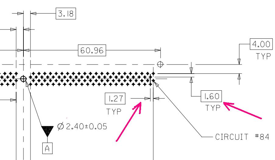

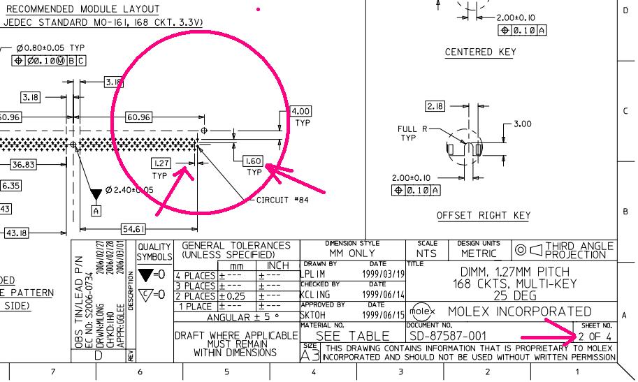

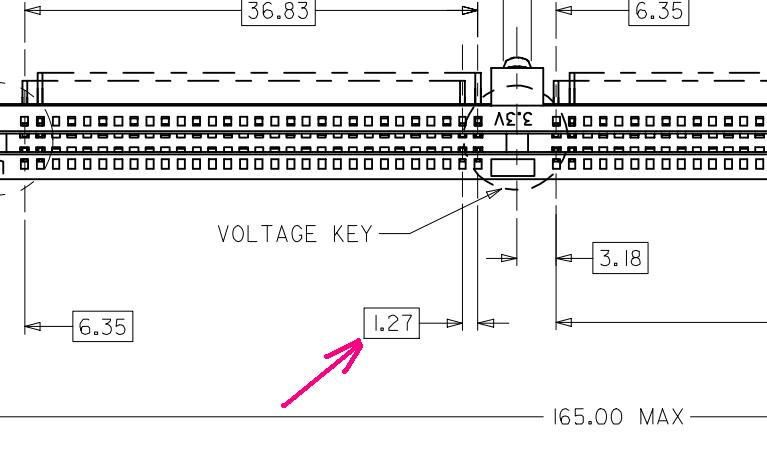

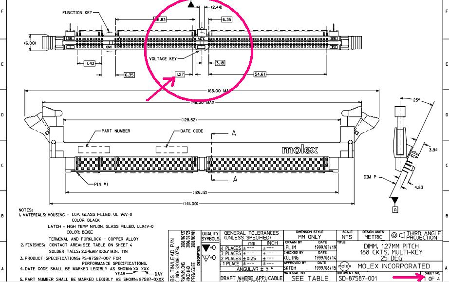

.050", or 1.27 mm
I dont thibk you'll get that in perf, you'll need a 100 leadouts to do that.
You can remove solder bridges from smd's by using desoldering braid, I usually deliberatly put too much sodler on then remove it like this.
You can salvage ram connectors from old motherboards using a hotair paint stripper gun.
