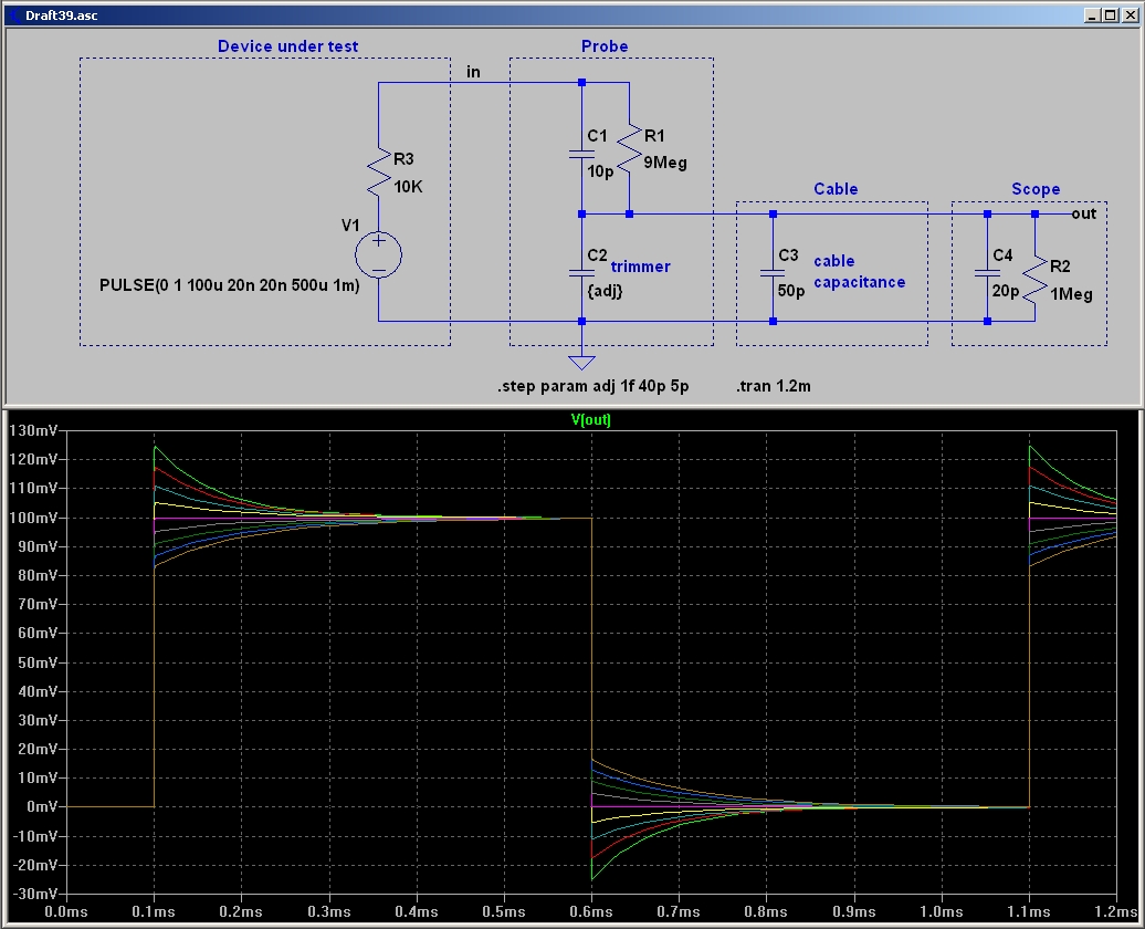

Look at the sim. The 10:1 probe is compensated when the trimmer is 20pF for a total shunt capacitance at the bottom of the divider of 20+50+20= 90pF.
