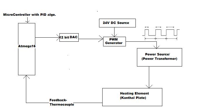

I want to design Heater which can produce heat around 25 to 600 Celcius using DC source.(Please see block diagram in attached file before reading.)
(1) I have a Kanthal Plate as a Heating Element.
(2) I don't know how to calculate power requirement for generating this amount of heat.
(3) I want to use PID algorithm for controlling close loop system where, thermocouple as a feedback sensor. I have a Atmega 16 microcontroller.
(4)Now, for generating power equivalent to desired temperature, I have planned following flow....
(A)Microcontroller will send command to 12 bit DAC(0 for min. and 4095 for max. power)
(B)12 bit DAC will generate analog voltage according to the input from controller.(0 to 12V)
(C) Now, using this voltage I want to generate PWM signal for 24 V source(or any value DC , not specific 24V).
(D) then, this PWM signal will be given to the power generator like power transformer to heat the kanthal plate. (is this making sense?:confused:)
(E) And temperature will be sensed by thermocouple and feedback to controller..and again using PID algorithm...It repeats and maintains the temperature...
Is this making sense????? Can you guide me regarding PWM generator and power generator part...

The Atmega16 can generate a PWM signal, read the PDF for the exact registers you need to setup to do this, the frequency isn't excessively important in your application. The simplest power driver for a heating element is simply a large logic level Mosfet that can handle the current your heating element can take. You adjust the duty cycle of the PWM to control the output power.
Your power requirements depend on the material you're heating, how fast you need to heat it and how insulated it is. Reading a thermocouple is going to require cold junction calibration and an amplifier.

I am developing this instrument for scientific experiment , in which user wants to heat their samples upto specific temperature and hold it for a while for reading,...i dont get your "600 C is pretty toasty"...what are you trying to say?
Regarding pwm in Atmega16, I haven't used it yet,,,,but this 5v pulse from same will be able to drive power mosfet...or power device(current rating??)...if yes can you give me that device no..and if possible schematic of what you are trying to say....

What's the voltage and current spec's for the Kanthal plate? I'm not sure why you want to PWM 24VDC to drive a transformer to drive a heating element. ???
If this is for a real research application, you will be time and money (if time is indeed money) ahead by going on eBay and buying a new/used/old-stock PID temp controller and a solid state relay. Like: PID temperature controller, Business Industrial, Computers Networking items on eBay.com
Reinventing the wheel is only useful if you want to know how wheels are made...including all the ways of doing it wrong. ;)

ok then, can you suggest me something if you want around 600 degree Celcius temp. maximum, using DC source(any voltage) and then maintain particular temp. without on/off algo.,......how will you approach???
By "project" do you mean an academic exercise?
First step...same question..."What's the voltage and current spec's for the Kanthal plate?"
Second...How accurately, at 600C, must the controller maintain temp?...+/-1C?...+/-10C?...think real world.
Third...Is the Kanthal plate in an insulated container or open to ambient air? Consider the thermal mass of the plate in its environment.
Build your specifications first, then we can look for possible solutions to build.

so far...kanthal plate requires 100W ...error temp. must be ≤±1 degree celcius. and kanthal plate will be in the container...
now regarding smps transformer...i am looking forward for this kind of transformer shown in a link...https://www.electro-tech-online.com/custompdfs/2009/05/e6355_srw.pdf
my idea for controlling the power is shown in the link.
Again..."What's the voltage and current spec's for the Kanthal plate?" 100 watts is the power...4A@25V?...0.8A@120V?...or even the resistance of the element?
"≤±1 degree celcius" @ between 25C and 600C is going to be a real challenge. I wish you luck.

I have asked about voltage and current to senior...he said 100Amps. 1 V..
but why? still I don't know... may be I²R....

why variable output?? as far as I know ideally or theoritically I am giving the same output to plate but what I am changing is the duty cycle of the output by controlling the mosfet switch connected to flyback transformer....am I right???
I agree, that doesn't seem right. I think you had better get that specification absolutely verified before you proceed.
We may have a confusion about the power supply design you are planning on using. Can you post a schematic or link?
