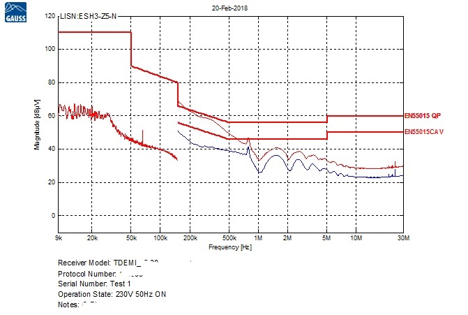

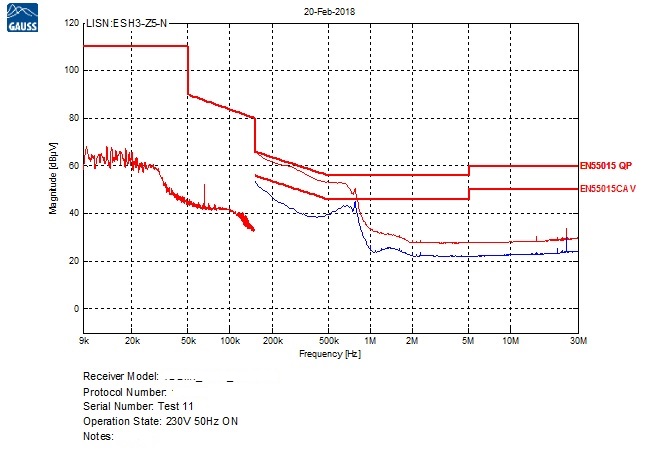

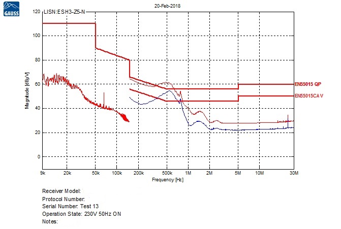

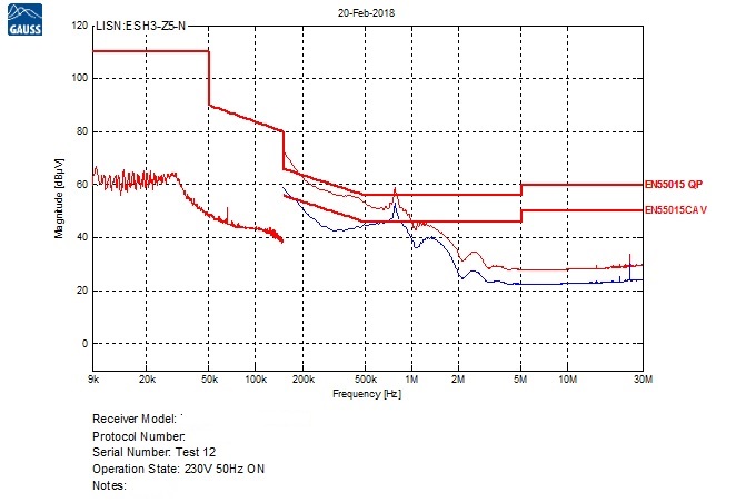

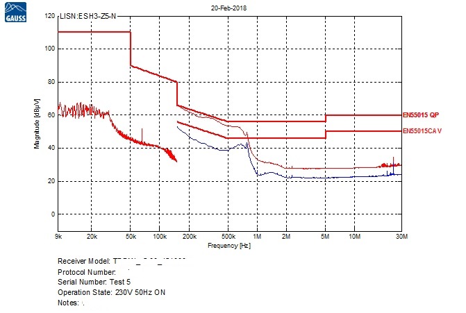

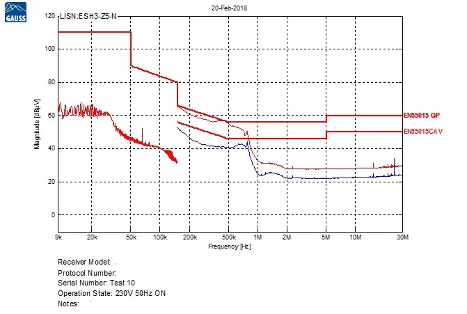

For the following Conducted EMC scans, we changed the values of some of the filter components shown in the pdf…….changing the Inductor values to try and get it to pass conducted EMC….
We started off with scan A. The filter values for this were as in the schematic.
Scan A is a fail around 150Khz.
Therefore we changed the damping resistors (R2,R3) to 1k, as in scan B, and then it was still a fail at 150kHz, but less badly failing than A.
Therefore we kept the 1k resistors for R2 and R3, and then increased L3 from 47uH to 100uH as in Scan C. However, this was worse than scan B at the failure frequency of 150kHz. That is, increasing the filter inductance, made the conducted scan worse. This made us realise that our problem is predominantly a common mode problem. 150kHz is not a usual frequency for a common mode problem, but as you know, the 150kHz is simply the frequency of the” envelope” which comprises the much higher frequency common mode disturbances.
Anyway…we then reduced L3 to 22uH and finally got it to pass (hoorah!) as in scan D.
However, the readout for scan D strangely says it’s a fail at 150kHz because it recorded exactly 66dBuV and that is exactly what the limit line is at. –So the official readout said that we failed by zero dBuV (!!!).
Anyway, in a desperation to get further below the limit line, we then kept L3=22uH, and kept R2,R3=1k, but increased L4 and L5 each from 100uH to 150uH. This is shown in scan E.
..However, this is worse than scan D. –It fails badly around 500kHz. Again it showed that increasing the filter inductance, made the results worse.
However, decreasing L4 and L5 each from 100uH down to 47uH also made the result worse. So therefore we have currently stuck with R2 & R3=1k, L3=22uH, L4 & L5 = 100uH. (ie scan D) The rest is as in the schematic shown.
However, as scan D shows, we are too close to the limit line, and need to reduce the noise more….
