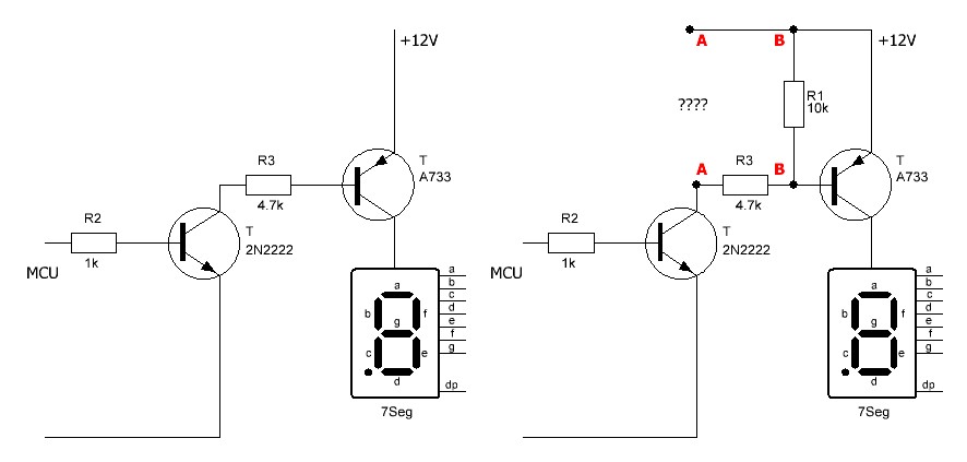

I am multiplexing 4 seven segments (Common Anode).The problem is most of the time, inactive segment elements also lights up very dimly.It is noticeable at night times. By adding a 10K pullup resister to the PNP transistor solved the problem.
My question is what is the best place to add it?A-A or B-B ?Currently I added the resistor to B-B position.

I would say that between B-B is slightly better but it does not really matter. Why are you using the 2N2222 to invert the signal from the MCU rather than inverting it in software ? If you are interested I have a very similar circuit for a tachometer using a PIC16F628 The details are on my website. https://lesjhobbies.weebly.com/
There is the schematic and source code so you can see the code I use to drive a multiplexed LED display.
What you didn't implement is "inter-digit blanking". You have to turn the current digit OFF before setting the new value for the next digit, otherwise you get a ghosting effect.

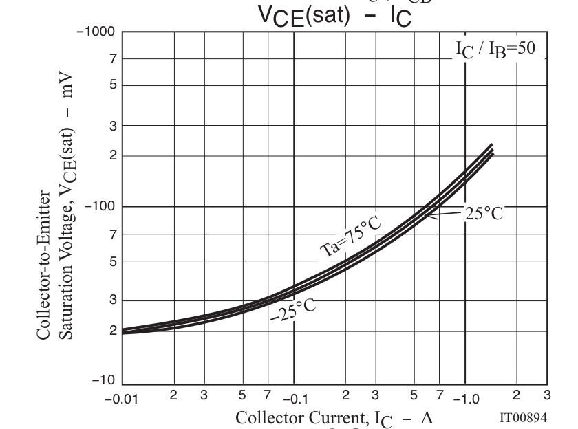

This transistor is rated for Ic/Ib=50 or 20 with Rce(sat) ~1 Ω see slope of graph at 0.6A above,
https://www.digikey.com/product-detail/en/MCH6101-TL-E/MCH6101-TL-EOSCT-ND/5213273
If the question about inter-digit blanking is referring to my tachometer design then it is implemented in the first two lines of the "Display_Next_Dig" code.
Display_Next_Dig
MOVLW 0x0F
IORWF Dig_Port,F ;All digit drives off (Active low) Bits 0 - 3
BTFSC Dig_Count, 1
GOTO TwoorThree
