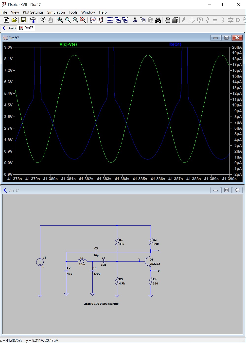

Colpits Oscillator
Quasar999
Hello
i'm just design a Colpits oscillator in order to understand it but i have some doubts. In attach the simulation of the circuit but i can't adjust the feedback correctly, as you can see the transistor goes everytime in saturation and i can't find a way to avoid it.

But the base current got a peak due to the transistor saturation. Is possible to let the transistor work in the active region?
Why?.
I suspect you're missing the point of an LC oscillator - it's like a bell, you 'hit' it and it rings.
You could reduce the bias, but then you've got the issue of it not starting reliably.
So that's the normal behavoiur of a lc oscillator? Ther bias is correct but the amplitude of the current seems too much with no control.
Yes - for an oscillator to give a sine wave you need an accurate and exact amount of feedback - too little it won't oscillate, too much and it will be distorted (and even a square wave). Even worse, the gain varies with temperature, supply voltage etc. This is why wein bridge oscillators have some kind of control system in the feedback network to compensate.
An 'easier' solution is to use an LC tank, and allow that to create the sine wave - you can then have much higher gain, and the tank circuit takes care of reducing distortion.
R4 provides the negative feedback to control the current. the technical term in the case of R4 is "degenerative feedback"
Correct. But there's only precise value for the oscillator to start (i think is due to the Barkausen Criterion) but over that you'll have full saturation of the transistor any cycle. No good regutation si possible, maybe with a variable capacitor but the temperature will move the equilibrium.
