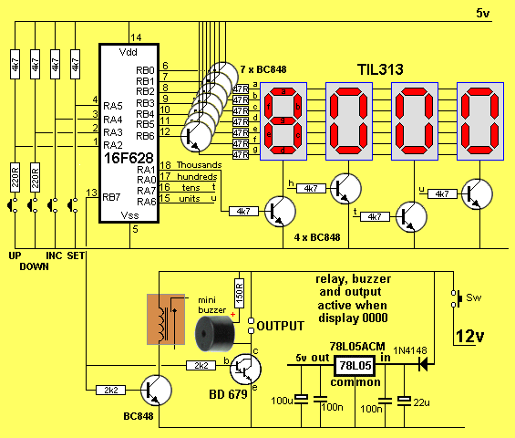

It's much simpler to use this 4 digit counter and change the program.

Maximum duration of the 99s is too short. Blitz game last at minimum 3 or 5 minutes, usually 15. It is possible to trim 555 timer, however players may lost some sense of real time.
Certainly it is far easier and cheaper to use any MCU, however this is great way to familiarize with logic gates and some other basic ICs.
What actually recommendations of the project are?
