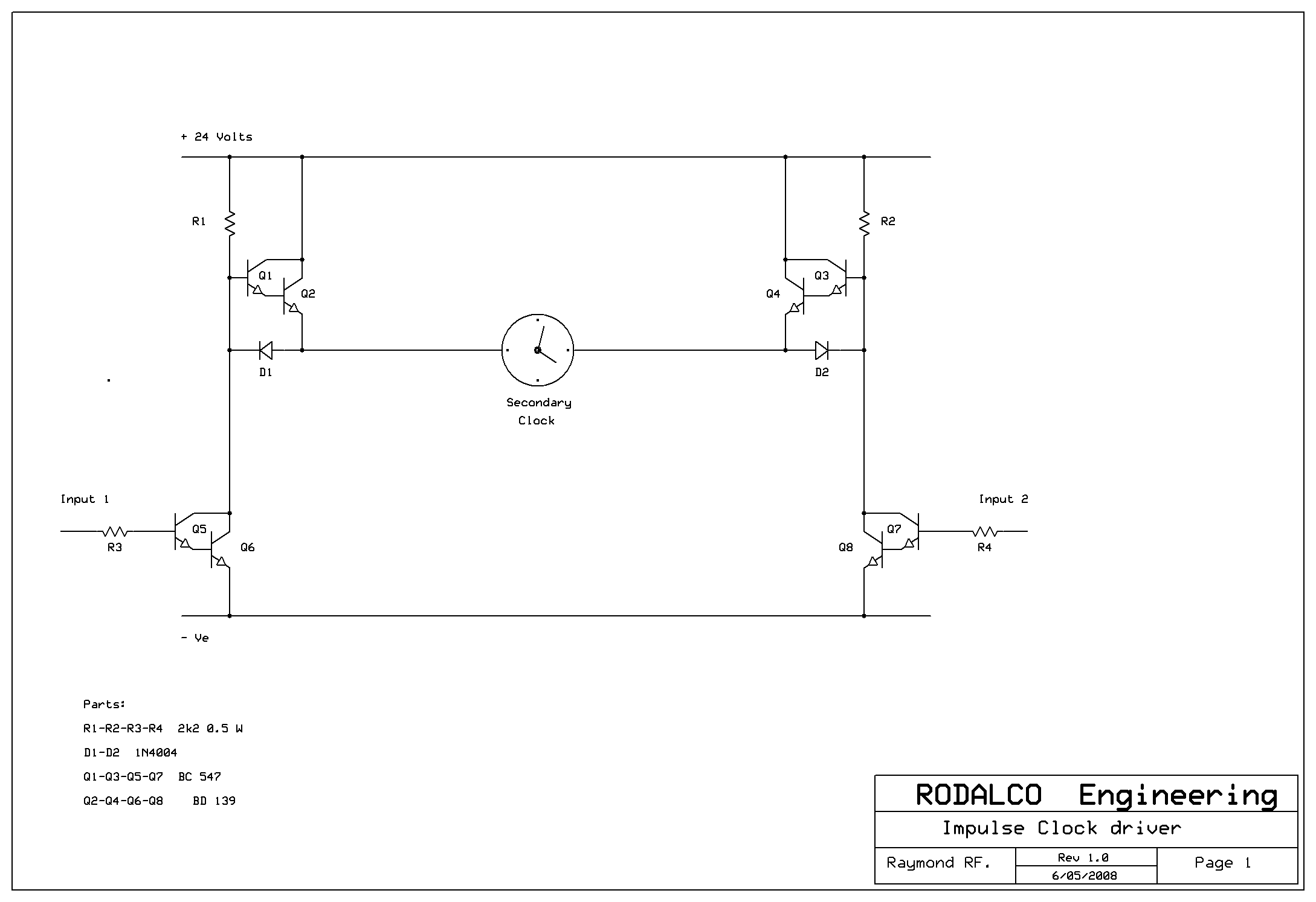

These require short (about 1 second) 24 Volts dc, 1 minute impulses every minute and the polarity needs to be changed every time.
To have maximum accuracy, if you run them of an electronic supply, use a crystal oscillator and dividing counter IC, as already suggested by our other members and take off 1 minute impulses to drive an H bridge made of a couple of powertransistors.
I can dig the bridge circuit up if you require it.
Regards, Raymond

Attched is the schematic for the H - bridge.

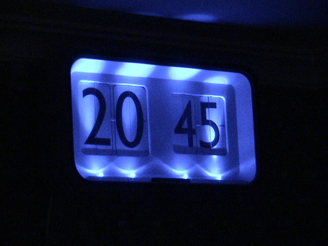

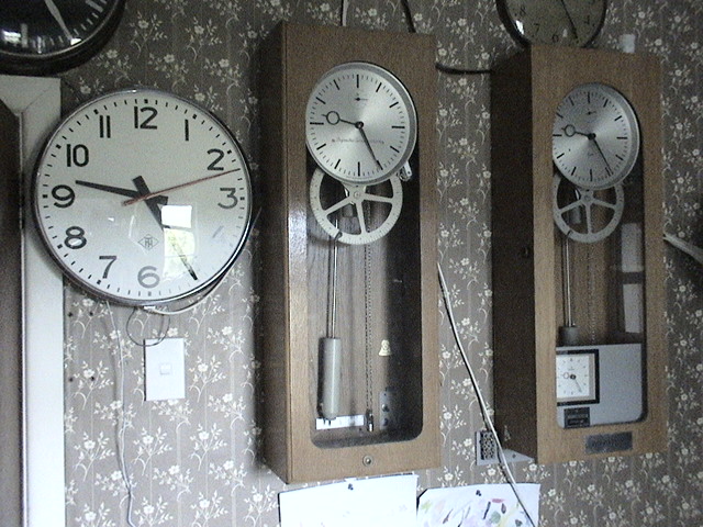

Also a photo is attached from two Bürk masterclocks, I have 6 of them, and one of my Cifra 12's with blue LED's as enhancement.
These Bürk master clocks are often on sale on Ebay Deutschland (Germany).
Look under Hauptuhr, Mutteruhr.
and check that they have 24 Volt output via mercury switches, visible at the left of the dial.
Some Bürks drive direct 220 Volt tower clocks and are not suitable unless additional relays are added.
In the UK you need to look for an ECS memory masterclock which has alternative output pulses. Often 24 Volts but with a series resistor you can use the 6 volts clock coil ok.

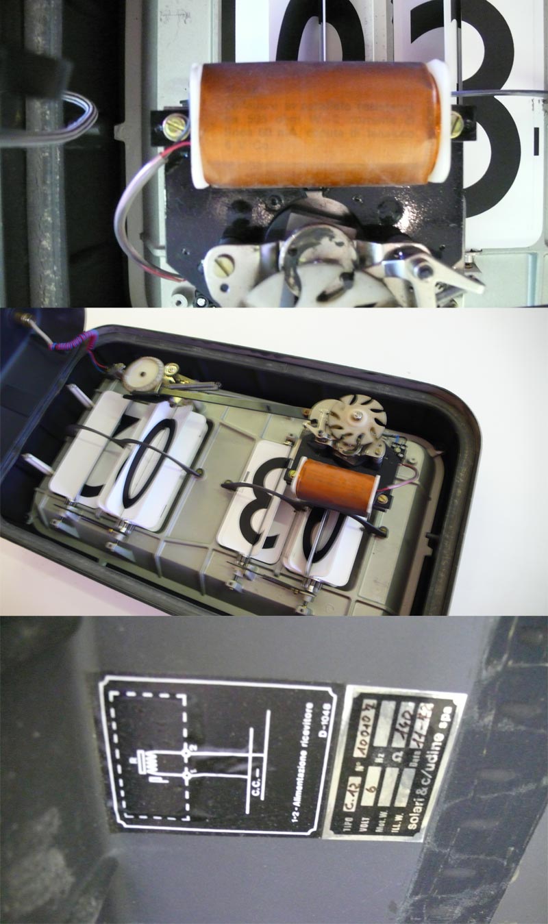

Can you confirm how to drive my Cifra 12 - everything I've read is different to how I've managed to get it to work.
Mine seems to need two alternating pulses to move the clock forward one minute - where as everyone else seems to describe it as the alternating pulse being every minute (which would make my clock work half speed?!)
Cifra 12
You say that yours need two alternating impulses to advance the clock one minute ?
e.g. impulse - pos 6 volts, click, neg 6 volts, dial flips, pos 6 volts, click, neg 6 volts dial flips ?? like that ?
That could be a set up for probably a French clock system, some of those use 30 seconds impulses.
Can you make a close up of the actual actuator? which drives the white odd shaped wheel with the 10 curved notches ?
If the actual drive has 1 pin than it is set up for the 30 second pulse.
Can easily be made to accept 1 minute pulses if the wheel has the second hole (which is not used in your case).
There should be a second hole to add an other pin, which makes it suitable for 1 minute impulses.
I have one of those, and simply added a wooden sateh stick in the spare hole, fitted perfectly and the clock runs perfect for over 2 years of my Bürk master clock.
The ebay listed clock is suitable as master clock and has a built in low voltage 12 or 24 volts supply and provides alternating pulses to drive the Cifra 12.
I had an other look at your first photo and it looks that the drive wheel has only one pin. (photo is a bit dark, ok, my 21" monitor is old too) :D
Add one and your clock will work at the correct speed.
Cheers, Raymond
