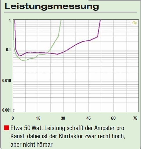

Well I did some digging and found a German review for the tangent ampster BT. Well, the distortion curve is a little disappointing, but I listen to a lot of different types of music and I personally don't notice any colouration of the sound, but then my ears are 40 years old. Perhaps in a blind test alongside a more expensive amp I might be able to notice the difference, I don't know. However, listening to it, I would not have guessed the best it can do is around 0.1% THD, give or take.
Translation "About 50 watts of power creates the Ampster per channel, while the distortion is quite high, but not audible" According to google, that is
The distortion measurement is at only one mid frequency. Maybe it distorts like mad at low and/or high frequencies?
Does it roll off (attenuate) high frequencies to also attenuate high frequency distortion harmonics?
A man who is 40 years old has a significant mid and high frequency hearing loss so they turn up the treble (like my hearing aids do much more) to hear better.
0.1% is the point where most people begin to notice distortion (somewhere in the range of 0.1 to 0.5% depending on the person's hearing).
