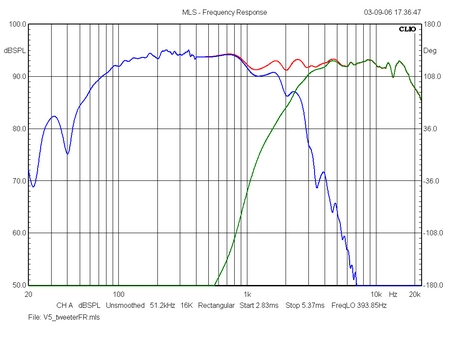

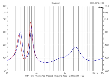

Not at all true, a decent crossover with 8 ohm speakers produces an 8 ohm load - there may be a dip around crossover frequency, but this is probably less than the dips on the individual drivers, and still results in an over all rating of 8 ohms.
And while a crossover doesn't 'use' power, it does waste some of the power passing through it.
What I was saying is that a 2-way speaker can play a low frequency from the 8 ohm woofer plus play a high frequency from the 8 ohm tweeter at the same time. Then for that moment the total load is 4 ohms.
No.
That is like saying a single wide range 8 ohm speaker is magically 4 ohm if you put two different tones through it simultaneously.
As each crossover transition is gradual and if you graph it against frequency, the series impedance to any one driver will start to increase well before the next unit takes over.
Both will have added impedance at the changeover points, keeping the amp load near constant if everything is properly matched; in practice it seems more likely to result in slightly higher impedance near the crossover frequency,
No even a really cheap crossover should have low impedance to two different drivers at any frequency!
Example plots for a well matched system - impedance
Output level
I did not say that one 8 ohm speaker is 4 ohms when it produces two frequencies.
Instead I said that an 8 ohm woofer plus an 8 ohm tweeter both playing tones in the middle of their frequency ranges are a load of 4 ohms on the amplifier.
The crossover network does not prevent the tweeter from playing a high frequency when the woofer is playing a low frequency and visa-versa.
