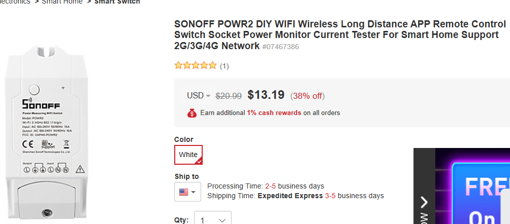

I have a box full of remote switches from Sonoff. I have not tried this one yet. This type not only allows you to turn on/off the switch from your phone but also tells you how much power the light is using. 0 power=failed bulb. It uses your wireless network!
Nice, I've not seen that one :D

That is really slick for the buck. Thanks for putting it out there.

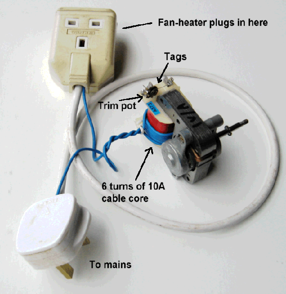

Don't think it's critical. I've even used an old shaded-pole mains motor as a current transformer.
The blue wire is mains neutral, which goes the scenic route around the motor core a few turns.
(The fan-heater was just a test load).
wow, that's a pretty good solution... those motors are very common
