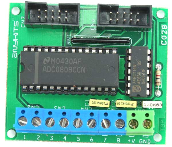

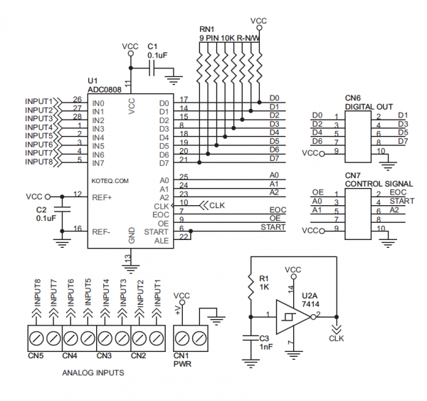

if I understand correctly, you need some kind of adc module. There are several modules below. You can use them. if you want a wave with a certain frequency in the digital response of each analog signal, you should use the embedded system.
Good luck with it ;)

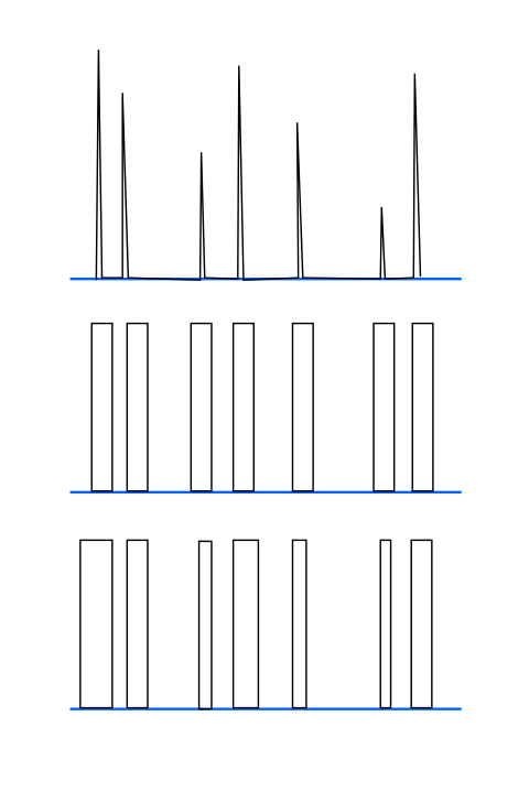

Thank you for your reply. As requested, here is a sketch of what I am trying to achieve. The original spikes are at the top. The second drawing down would be acceptable. The third is better, provided it does not overly complicate the circuit.
I am hoping to use parts on hand such as common op amps or CMOS IC's.
The circuit into which this will be incorporated is powered by +/-6VDC.

The graph, as you have drawn, is not possible because the output starts reacting before the input starts. It's non-causal. Did you mean to draw it this way?
No. The sketch is not that precise. It was just meant to represent the wave forms not the timing. The square waves would be conventionally triggered by the spikes.
Then I agree with Alex_t. A monostable vibrator triggered from something like a zero-cross (or some other comparator-type circuit) would get you the second graph.
How did you want to deal with impulses that were closer together than the pre-defined square-width pulse? I think if a regular 555 monostable is triggered in it's unstable state, it just resets the timer and continues to stay high.
You might be able to get graph 3 if you have an op-amp directly charge the 555's charging cap through a diode to make it behave like a buffered peak detector. It would have to be triggered off the 555 timer so it's only charging when appropriate and sounds like a lot of trouble to me. Not sure how well it would work though, especially if the impulse spikes are really short and fast. I also don't think it will be a linear relationship between peak value and pulse width.
I would narrow the square wave duty cycle at the monostable for optimal output. Might not catch every spike, but that's OK.

It appears that the first output is a constant pulse width for each spike. This can be done with a simple monostable circuit. The second output looks like you want the output pulse width to be proportional to the input pulse amplitude. This can be approximated by an integrator followed by a comparator, but the output pulses will be delayed in time (phase shift) slightly, depending on the integrator time constant.
IF the input spikes are variable width as well as height
ANDIF the width is loosely proportional to the height
THEN a comparator will turn out pulses of varying width

Thank you. I probably now have enough ideas to breadboard this. I will try just a monostable first (LM555) as most recently suggested. Will get back if I encounter problems.
The spikes are probably too narrow to easily detect any change in width.
Might also try a comparator or op-amp configured for high gain. Compare the input signal to a reference, and the output would be high as long as the impulse was greater than the reference.
I was more interested in the time domain, i.e. spacing between spikes.
Essentially, I just want to expand the spikes "on" time along the X axis so they resemble square waves with the same uneven spacing as the spikes.
I then intend to low pass filter this to produce an analog-like wave form.
Doesn't this just need a monostable multivibrator set to shorter than the shortest gap?
Why not just lpf the spikes and apply a gain of 2 to the result? If a spike is a true triangle shape then its area is half that of the rectangle (square-wave) which would enclose it, so the lpf output would be roughly half that which you'd get if you lpf'ed the square-waves.
