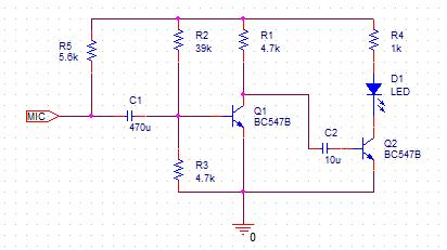

Circuit that allows snap of fingers creates equal flash from LED?
You need an amplifier that uses supply current all the time. Maybe you can find a low power amplifier IC. Then when it receives a signal from the microphone it feeds a rectifier that produces a DC voltage that turns on the transistor.

Is something like this that you want?
I made this with parts that were laying on my work table in less than five minutes without doing any math. And with two simple BC547Cs.
Of course it could be improved. And a lot. With emitter resistors and stuff.
This was just to show that no, you don't need an IC to do that.
What's best, or simpler, is a matter of taste.
Transistors work fine.
Edit: There are two major mistakes in the schematic, which are:
1 - I forgot to draw the Vcc (in this case, 5V from a DC power supply)
2 - The resistor in series with the LED is a 39R/1W resistor.

Caster, it's probably obvious to you experts, but where does the Vcc input connect exactly?
So you quickly built it, and it worked!? A snap of the fingers resulted in a flash from the LED?
It is almost like the circuit designed by Colin.
The first transistor is turned off but heat will turn it on and if you scream into the mic or hit it with a hammer. The 470uf capacitor is 1000 times too big.

Yes, the heat problem could be easily solved with a emitter resistor bypassed to ground by a capacitor. The capacitor values was chosen following a simple rule: there were two caps laying on my table, one 470u and one 10u :)

In Caster's circuit both transistors are not biased correctly so they do not work.
His and Colin's first transistor are turned off so they cannot amplify the low level signal from the mic unless you scream into it or hit it with a hammer.
If the first transistor is biased properly so it is an amplifier then its continuous current will kill your tiny battery in a few minutes. You need to find an amplifier circuit that uses a very low amount of supply current.
A "Keys Finder" project has an amplifier that uses a low amount of supply current.
The Keys Finder project at Electronics-Lab is not suitable.

Answering your first questions: The vcc goes at the "top" of the circuit, conected with all those "top" resistors.
The emitter resistor is a kind of negative feedback added to the circuit, that reduces the gain but makes the circuit much more stable to temperature variations.
The whole temperature problem can be resumed to the following:
The current flowing through the colector tends to get much higher at higher temperatures. Increasing the temperature also makes the base-emitter voltage drop become smaller. This effects makes the overall current flowing through the transistor increase. The increase of the current increase the power dissipation, that increases the temperature, that increases the current even more... You see the problem, don't you?
Placing a resistor betwen the emitter and ground makes everything much better.
When the collector current increases due to the temperature, the voltage at the resistor in the collector also increases (as V = R*I). This reduces both the Collector-emitter and the base-emitter voltage, almost solving the temperature thing.
You can calculate some parameters related to this phenomenon, called the thermal stability factors. Mathematically speaking: if you know the partial derivative of a certain circuit parameter (such as the collector current, for instance), with respect to the temperature, than you can quantify how big is the problem at your circuit.
Simplifying things: this parameter, called S at the book in which I studied this at college (Millman....), can be approximated to 1 + Rb/Re, where Rb is the thevenin's equivalent resistance at the base of the transistor, and Re is the resistance at the emitter.
The smaller the S, the better the circuit. As you can see, increasing the Re makes the circuit more stable.
The problem is that this resistor makes the voltage gain smaller. So, to make this compensation not interfere at signal frequencies, we bypass this capacitor to ground, so that it "vanishes" at higher frequencies (because the capacitor can be thought of as being a short-circuit at high f).

The output level from a microphone is very small and needs a preamplifier turned on all the time so it can listen for your finger snap. The preamplifier's current will kill your tiny battery soon unless you find a preamplifier circuit that uses a very low supply current.
I suggested looking for a "Keys Finder" circuit that also has a preamplifier that is turned on all the time.

Colin's new circuit has a current drain of only about 0.5mA by the electret mic so button battery cells will last for days.
But since the first transistor is turned off then it takes heat or a very loud sound into the mic to turn it on.

Do the 1M+100K resisters effectively act as enough of an "open" to prevent the 1M+100K resisters from completeing a circuit back to the battery, and draining the battery?
I understand the 10K+microphone loop is going to drain current, but won't the loop that consists of the 1M and the 100K also drain some current?
Or is that such a high resistance that it almost acts as an "open"? And if it does almost act as an "open" for that reason...what do you need that circuit path for? Why not just remove the 1M/circuit path completely?
In Caster's circuit (that worked but may drain battery?) that same area adds up to 43.7K...so even less...
Or is my math/understanding wrong on 1M+100K total resistance through the 1M circuit path?
I think I understand the circuit, except for THAT loop...:confused:
And, will the battery see the 10K being in parallel with the 1M, cause the 1M+100K path to be even less?
What is the resistance in the red loop, or can it even be looked at that way?
In other words, what exactly is that 1M/circuit path there for? Do you even need that circuit path, or can everything on the BASE side of Transister1 go through the 10K/blue loop? Why not take the 1M resister out completely?
