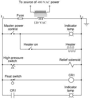

You would be much better off to draw it out in ladder format.
The Schnieder schematic book won't upload as too large, I can send it if you wish to P.M. me an email add.
I will be back later on today.
Max.
Ladder is a format for simplifying the display of a circuit.
NEMA standard is the power rails are on each side and the rungs progress downwards.
For IEC the power rail is horizontal across the top and progress down to the bottom horizontal power rail.
It is far easier to trouble shoot than the literal physical format alone.
Max.

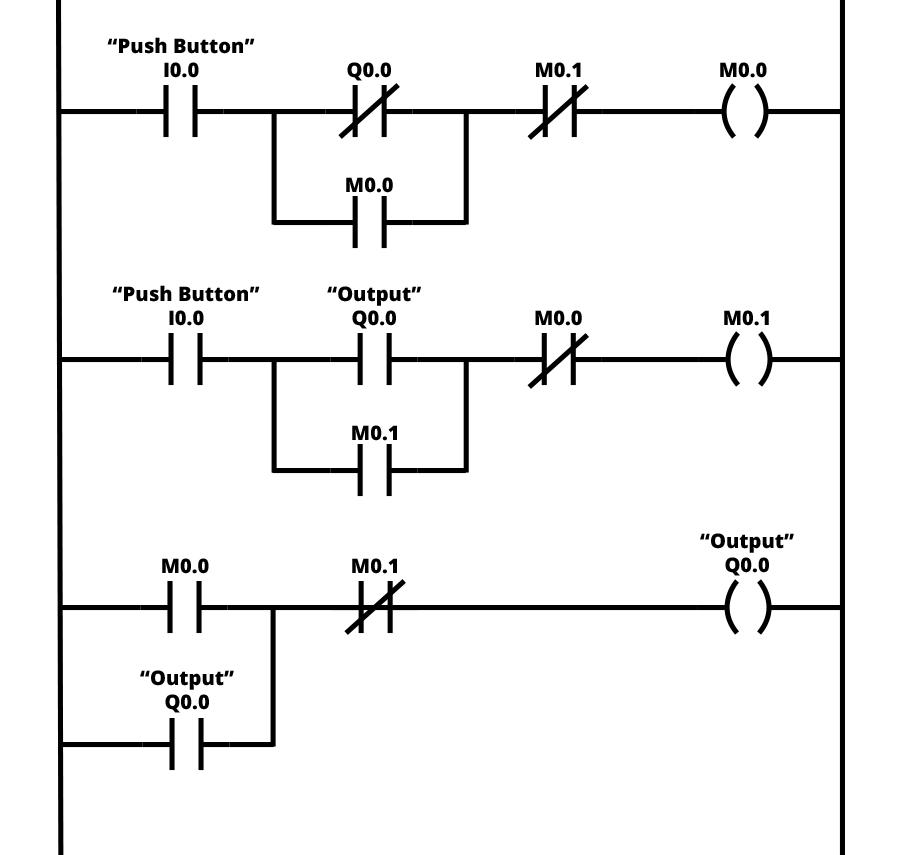

> How would one show this in ladder form.
I don't use ladder form. It may be simpler for some people but
that's not me.
> I am currently checking out ou-tube may have it figured out in a few days,
> and in the simulators all of the voltage controled/on-delay switches
> are spst, how does one modify or make a 8pin on-delay relay.
As a software person, if I couldn't just draw the schematic and
"simulate" in my mind, I'd write a short program. Python? Whatever?
Industrial control schematics have been shown in ladder format for some decades, the modern replacement for this is PLC ladder which mimics the drawn schematic form, one of the original reasons using it in PLC is it is much easier for maintenance personnel to trace a fault where active devices in any rung are highlighted as conducting, or indicate non-conducting, as the case may be.
Once used to it, it makes trouble shooting very easy, The reason for GM having it developed in the first place.
There are miniature PLC's now called Smart Relays.
PLC Flip-Flop
Max.

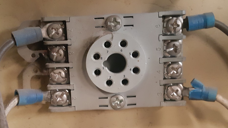

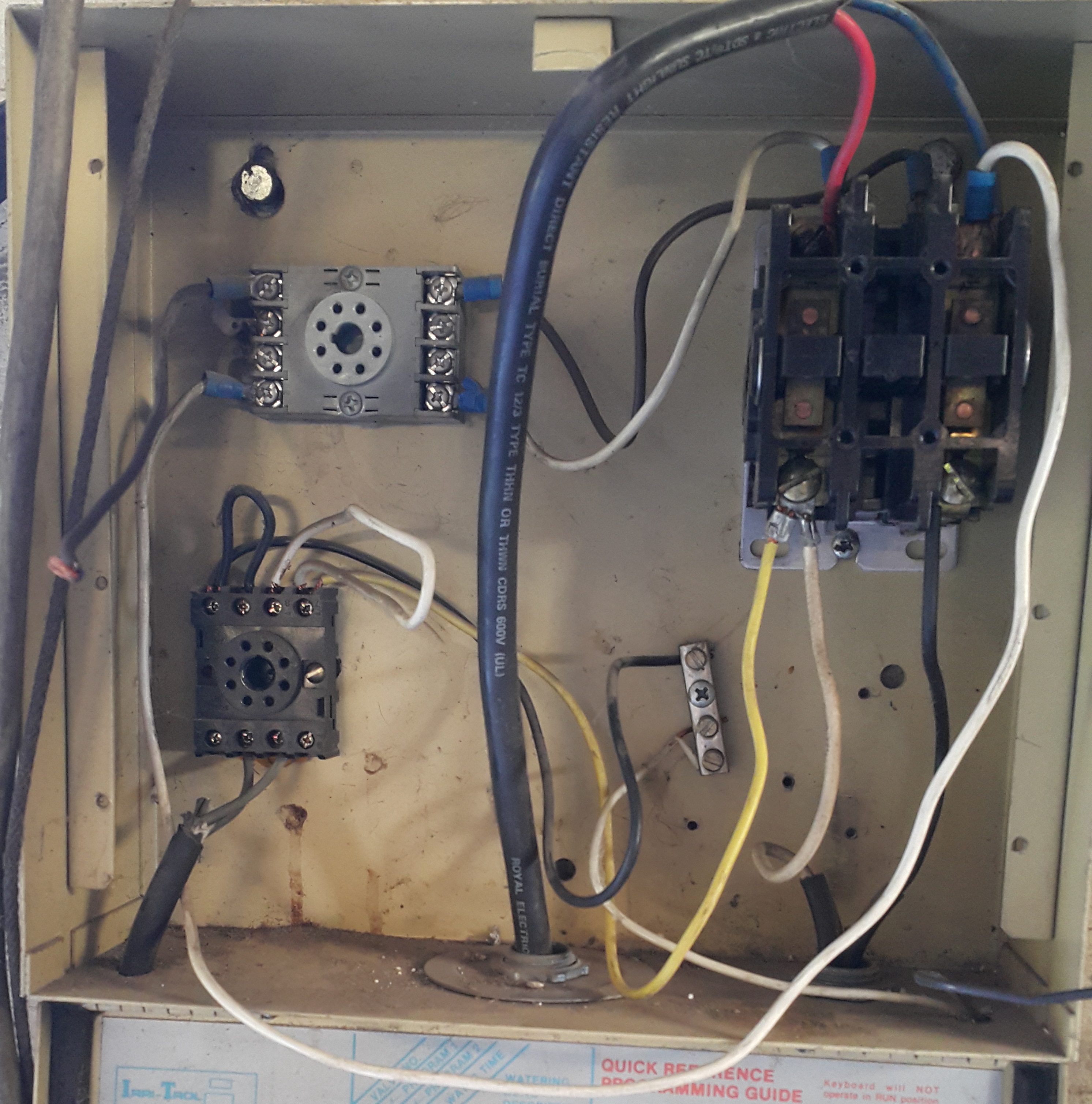

Hey micheal8,
I am the source of the drawing, I drew it from this (see attached image), and it is as drawn, connected to pin 3. The drawing is
correct and yes if connect to pin 4 and the circuit had a neutral return, I would not see any issues aside from the fact that one of
the on-delay relay coils burned out. thanks
DG.
Hey Max,
Is this a representation of my drawing converted to ladder form or is this a generic circuit. I understand the concept of circuit simplification by use of rungs on a ladder, I just don't know how to do it.
I will try and draw it up shortly, as already noted there appears to be anomalies in your original!
Max.
