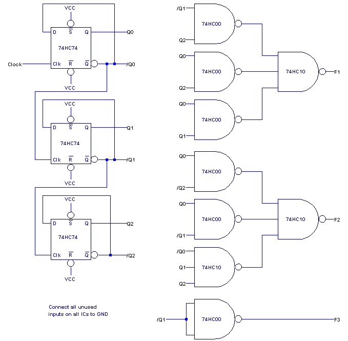

If you want to do it without programming (and sacrifice the flexibility that programming offers), you can do it with 5 small chips. The schematic is below. I haven't built it or even simulated it, so there may be errors in it, but I don't think there are. You will still have to add resistors and/or transistors and LEDs. The complexity depends on how much drive you need for the LEDs.
All the LEDs will go off for one clock period.

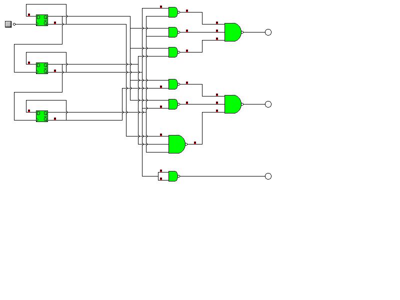

Well Ron, nice to see somone excersising their mind and doing things the old fashioned way! Anyway, I took the liberty to copy your circuit to a simulator and check I didn't get the expected result (I may have made a mistake somewhere!) so I may try again tomorrow!
Olly, you're right. I forgot that, in order to get an up counter, I have to clock successive stages off the /Q output of the previous stage. What I had was a down counter. I've edited the schematic to reflect this. Let us know if you simulate it with the changes.
Thanks,
Ron
