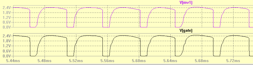

I've come up with the following circuit which works well in simulation (LTspice, file attached below):
Here's what I get from it:
Not too shabby for a couple of AA cells input. In addition, regarding the problems I described in that other thread about getting a decent MOSFET drive waveform, I'm happy to report that it's much cleaner now (see attached pic below). No more ringing!
The problem, and what I'm asking about here, is selecting an actual FET. I chose one that I found (the IRLML6346) available through Digi-Key, very cheap ($0.41). However, this MOSFET is surface-mount (SOT-23). I'm really looking for something more along TO-92 lines, since I'm hand-fabricating my project.
And of course, what's really more crucial are the device parameters. Of course I'd like to see the lowest Rds(on) possible, the lowest capacitance possible, and the highest current and power ratings possible. But I also want to use a small transistor, not a big old heat-sinked TO-3 or something. It's very difficult wading through lists of hundreds of devices trying to find one that's suitable. I actually find Digi-Key's parametric search the most useful here, as you can narrow down your search based on one or more parameters (Rds, power, etc.), but even that is time-consuming and frustrating; for instance, their Rds parameters not only specify the resistance, but also the DS voltage, so you end up going through the parameters one at a time, often returning zero results (since I'm looking for devices I can buy as onesies-twosies, not having to buy a lot of 2,000). So I need help!
