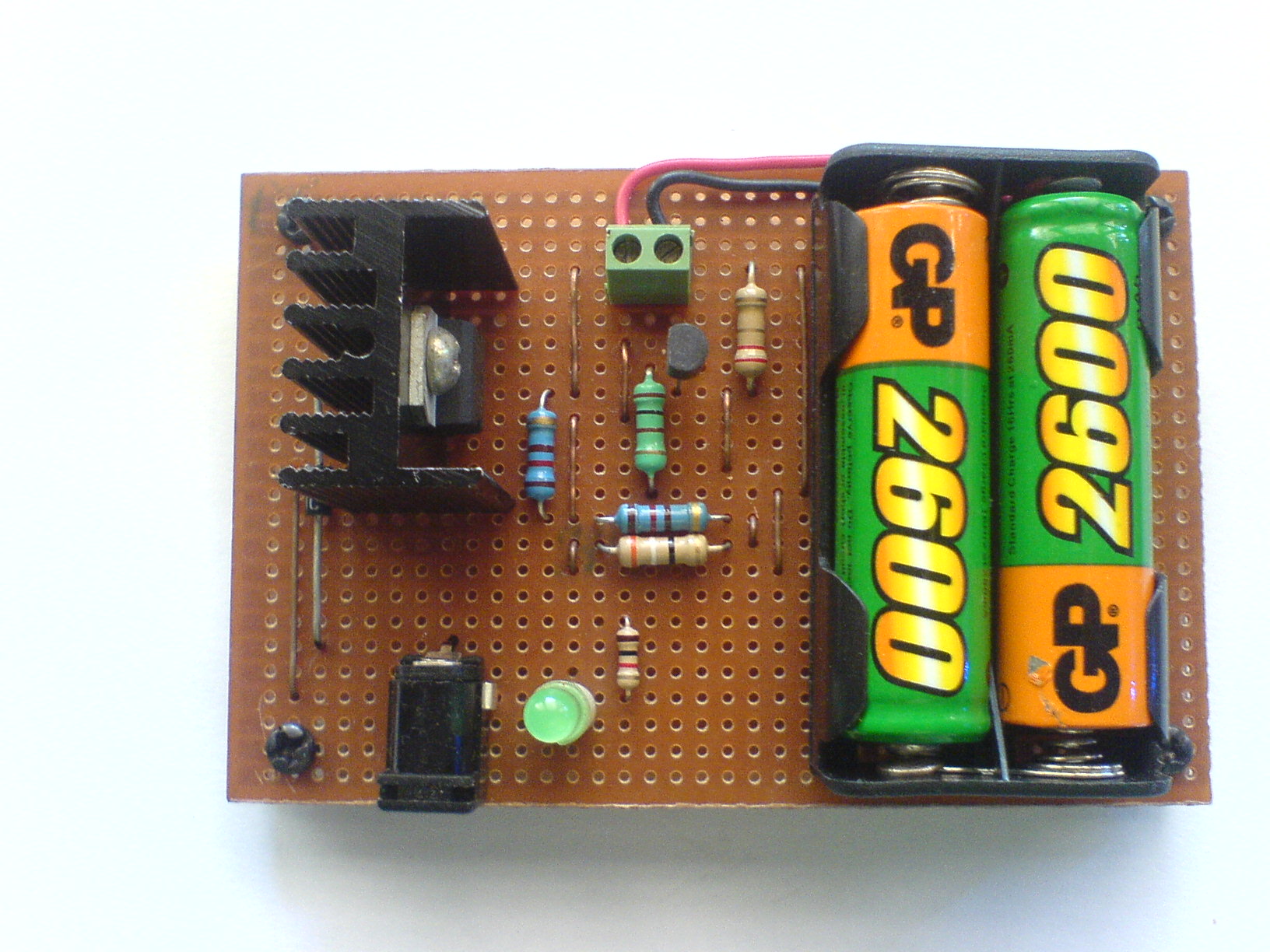

Here is my NIMH charger,I charged many NIMH cells without any problem.
If you charge your batteries at a recommended rate then no problem.
I have no hurry to charge my batteries.So I don't need any advanced detecting methods or any expensive IC's to terminate the charge.
This simple constant voltage current limited type charger gave me good results.
If you are hurry to charge your batteries or if you need to charge your batteries withing few minutes do not use this.

Hi k7elp60 I have noticed that when charging with constant current mode (ignoring constant voltage) the batteries will increase their voltages above 1.5V. So the batteries getting hot.Its exceeding manufactures maximum limits.
The batteries are not supposed to get hot. They get warm then they are fully charged and then charging current must be reduced a lot or turned off.
A battery charger IC monitors the voltage of the charging battery and shuts off the current when the voltage drops a little when it is fully charged and is beginning to get warm.
When a battery gets too hot then it "vents" and releases some of its chemicals. It vents instead of blowing up.
