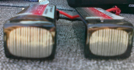

However, after using them, they tend to get really hot (can't hold them for more than 20 sec) and they swell.
They get back to their normal size after about 10 min.
I assumed that a small amount of swelling was normal because it happened on both my batteries, plus the batteries I use have a higher discharge rate then needed.
Is that normal?
You got me worried when you said: ANY swelling
Here's a picture
