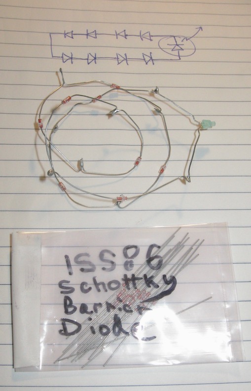

Hi, I Just ordered some 1SS86 Schottky diodes because I saw a U-tube video with 8 of them Powering an LED when held over a cell phone.
My circuit does not light the LED however sometimes for a moment in just the right position I see 1 volt dc across the LED. Normally though it's more like 250mv or so when the phone. is active and 20mv otherwise. 1SS86 Schottky Barrier Diode DataSheet. Infineon RF Schottky Diodes

You would likely be better off with a diode bridge with very short leads across the LED, and a couple of quarter wave wires (about 5 - 6cm? for 900 MHz) attached for the input.
I'd expect multiple diodes like that to lose more voltage than they pick up? Possibly the lead lengths combined to form a resonant loop in the original - or it's just a scam video..

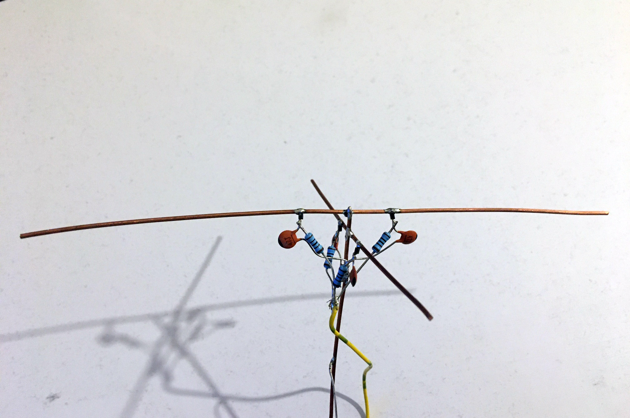

This is a gadget I built last year for a similar experiment - it uses two approximate half-wave dipoles for 900 & 1800 MHz, with surface mount ultra high speed diodes tapped at a moderate impedance point on each leg, to smoothing caps and resistors to merge the output.
It gives readings on a meter, but it's extremely sensitive to both its own and the phone orientation and distance etc.
(The resistor junction is well clear of the support - it's just the angle that makes it look like it's touching).

Using multiple diodes in series as per the video is a very bad idea.
Just use one diode and a loop of wire.

Yes, I know. Thanks for the post. Well Won't each diode collect some. voltage that would add up to more with more diodes. I know what your saying though. And "rjenkinsgb" is saying make them shorter. It makes sense to me that I need to match the wavelength. Lambda or Wavelength=Speed of Light / Frequency so at 900mhz. it would be Lambda = (299,792,458 m/s) / 900,000,000 = .333 m or 3.3 cm So Should each diode it sounds like would need to be in it's own 3.3cm long loop then maybe it would work better?
Each diode has a forward voltage drop of about 0.6v (Silicon diode)
So the wires of each diode would need to "collect" 0.6v befor any current could flow.
= .333 m or 3.3 cm
0.333m = 33cm

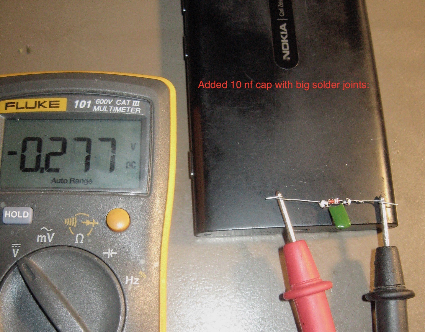

My Fluke (set to diode check not shown here) Measured the 1ss86 Schottky Barrier Diode to have a forward Voltage drop of 0.182 Volts.
I tried coiling the 8 Diode kludge with each turn being 3.3cm long and including 1 1ss86 Diode per turn. Got similar results around .450mv across the led. I did see 1.5 volts across the led once but no lighting. There is one spot on the windows phone that is hotter shown in the photo. Also tried a android phone and a track phone but got lower readings than the old windows phone shown in the photo below.

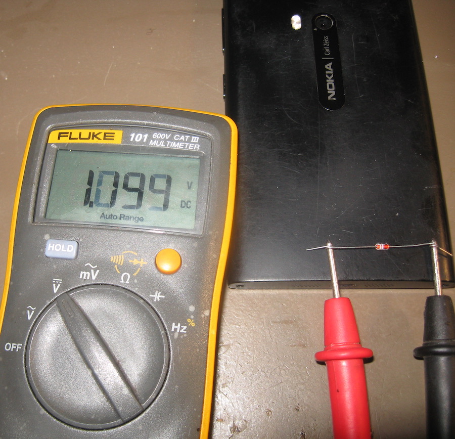

This is with just one diode which lays closer to the phone I had to take 5 or 6 photos to catch this reading other readings were 350 or 400 mv.

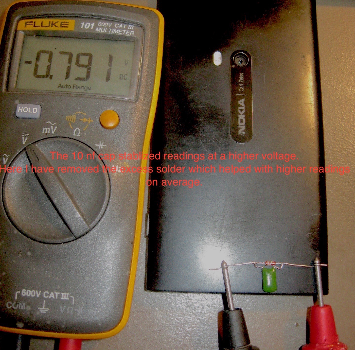

I added a 10 nf cap which stabilized readings and increased distance held from phone and interestingly less solder at the joints raises voltage on average. In addition readings of 0.3 volts with a 1.5K ohm resistor in parallel with just a diode calculate to 200 micro amps thats 60 micro watts.

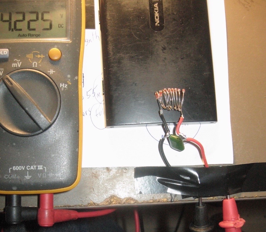

Ok so I rebuilt the 8 Diode detector remeasuring everything and soldering a lot more accurately an cleanly as possible, coiling it with 3.31cm per turn and using a .1uf capacitor. Readings now peak at well over 5 volts DC. Measured over 10 Volts DC once and over 6 Volts on the Android phone.

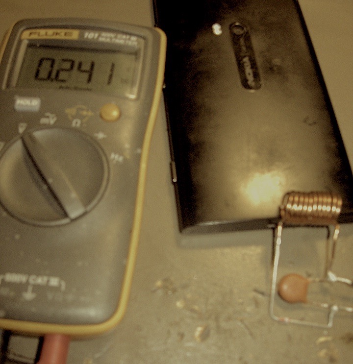

Now try it with a similar coil (ie same number of turns, same diameter, same length) of wire and only one diode.
Here it is. with just a plain coil and single diode and .045 uF cap. 0.241 volts was one of the highest readings with with this coil.

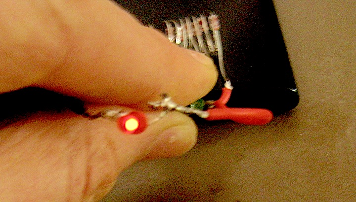

Here the 8 diode coil and .1uf cap connected to a LED and it flashes pretty good. There is a really bright flash at connect and disconnect.
