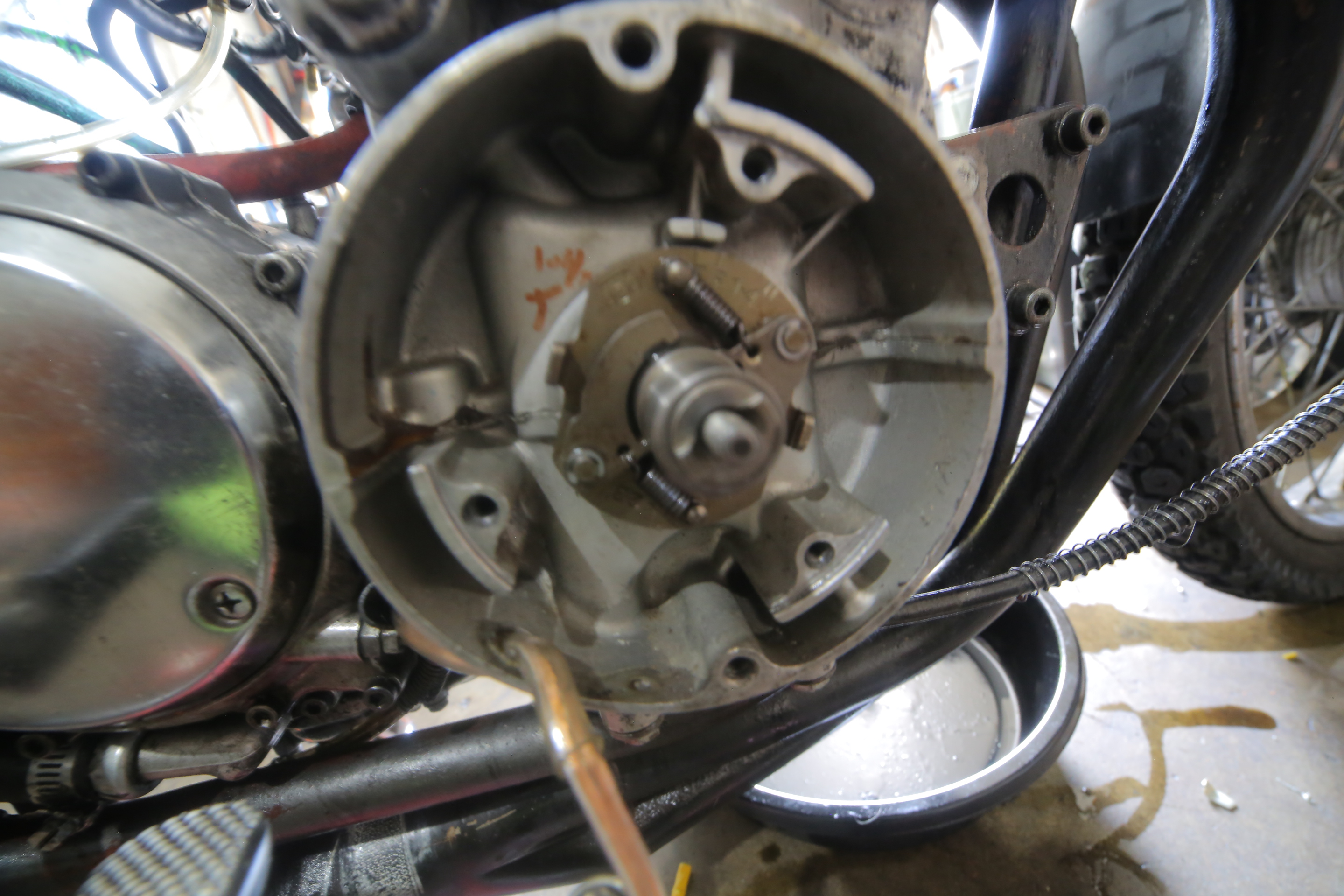

At the moment. I am digging for info on a DIY CDI or TDI setup for my old 1976 Honda CB750 motorcycle IMG_3615-2.JPG. Trying to go solid state and ditch the mech points. Have tested coils from Subaru and Dodge Neon but ohmage was causing coils to get WAY too hot so went back to stock 5ohm setup. Currently toying with mid90s Honda Accord pickup coils and rotator for pulse generation. IMG_3682-2.JPG Haven't landed on quite the right igniter module choice yet. Leaning towards the Subaru setup, as that is my winter rig of choice here in Spokane, Washington, USA (36302.1906, Town and Country, WA 99208)

Many have used the GM HEI module and keep the points. The points in that situation are just a low amperage switch and don't carry the amperage of the coil. They also use the GM coils. Here is one of them Google may show others - **broken link removed**
There is another member here that is good with anything ignition related, debe . He has in another thread on this site shown how to do it using Ford parts. Maybe by this post using his name he will chime in on your project.
yO, shortbus=, Thanks for the heads up on the GM HEI modules! Now running a truly global ignition system. Sealed gel battery from China, runs to the rebuilt killswitch from a 98 v45 Magna then to a 3 way split between an old Mopar ballast resistor (which I'm not sure I need any more but DID before I got all the pieces in place)right before current gets to the 06 Subaru coils, travels down 74 Volvo Bosch plug wires to NGK plugs while the other 2 leads from killswitch each go to a GM 7-pin 466 HEI module, one from a 84 Caddy Eldo, the other from an 86 Buick Regal which are being fed pulses from the pickup coils off a couple of Dodge Tradesman vans, one a burnt out motorhome shell the other an actually old trades dudvces rig, not sure which trade but leaning toward a plumber. With a handmade, custom 1 off reluctor by your truly. Now to find a replacement for the points cover, which I had been thinking about replacing for quite some time...
