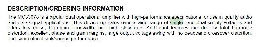

Reading about voltage on the IC I bought, I says it needs:
* Dual Supply Operation: +/-5.0V to +/-18V
https://www.electrokit.com/en/mc33079p.44016
I need one for single supply, guess I need to buy a new one ? :(
Data sheet sez:
Your design has to accommodate this
Yes, no big loss but annoying not to be able to test it today.
Would any of these be ok as a replacement?
Have you tried it?, there's no such thing as a 'dual supply only' opamp, the circuit configuration of the design creates a dual supply from the single one - it's an EXTREMELY common technique (and is even demonstrated in the sticky at the top of this very forum).

Not tested yet. Dont want anything to go bad :) you say it might work and that I already have that dual supply covered in my circuit? Sounds good, but reading the description on different opamps some say dual and some say single and dual and that got me confused. Im happy if I can use this one whithout more hardware.

I went back and looked at the schem for the tape echo circuit, it has a supply splitter as mentioned.
The op amp spec'd will work, so will others like an Lm324.
Dont get caught up too much in 'split supply' op amps, for your purposes its not so much an issue.
