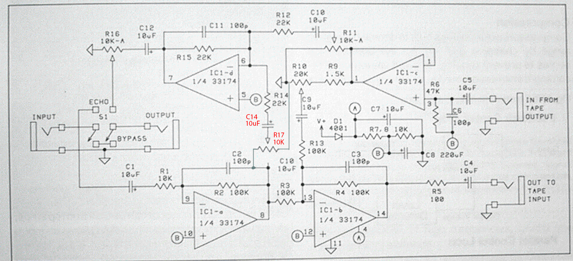

Sounds like you have some feedback, did you use screened cable?
Perhaps both issues you mentioned are due to the signal overdriving, if that is the case a resistor on the signal (non ground) end of the potmeter track might fix it.
I cant remember what speed compact cassette runs, 4 track reel to reel is something like 3 3/4" per sec, the 2 heads in a compact cassette are fairly close together so it wont take long to get from one to the other, hence a short delay, moving the heads apart wont be easy!
Yes, screened cables, except about a few cm close to the board. Did not integrate it yet inside the unit.
Do you refer to the feedback pot? That has already a 1.5K resistor in that end.
Or which one?

R11 & R17 I guess would be a start, try a 22k in series.
Try putting it in place temporarily, there will be some noisy spots & some Ok ones in the set.
Tested with 22k but did not help the distortion on one of the end of
dry pot, a bit squeling gone and also some delay.
I also tested to connect R11 to R17 unsoldered the ground positions and connected them together, that gave interesting results and distortion gone doing that. But dont really know whats happening to the circuit connecting the pots together like that?
Mixing the wet and dry together?
Disconnecting the pot grounds will more or less make them act like 1 that goes from wet to dry, only you'll always have a little wet and a little dry.
If that stops the squealing maybe theres some odd phase thing happening creating oscillation conditions, are the 100p caps present & correct?

The 100p should be correct positioned but could not measure them with my multimeter. Should I replace them?
Here is a video. The squealing can be heared about 0:40
Sounded good to me, just like the copykat used to.
Either my hearing is shot which is quite possible working in a noisy plant or there was no squealing on the recording.
If the 100p's are in and they are marked 100p (101) no reason to replace them.
There will be a point where gain gets high enough to amplify noise which on each echo will get louder & louder untill you get squeal, I think this is happening, if so theres not a lot you can do as its a hardware limitation, the best course would be to reduce the gain control so you cannot turn the gain up high enough for it to occur(hence my 22k idea), it makes a more professional unit where everything 'works' nicely.
Are you using a good quality tape?, naff ones hiss like a bad tempered cat, also try turning the tone down on the marantz.
Th eother thing in the back of my mind is the bias oscillator in the recorder affecting things, its a bit soon in the Am to work that one out now, I'll think about that one.
It happens only when the feedback pot is above 70% or the rec knob on the unit is above 5. The 22K resistor on the wet pot removed much of the delay, almost all. My 100p i marked 101. I would very much like to get rid of the squealings.

Tape recorders, apart from really nasty ones have a bias oscillator, the magnetic material in the tape doesnt respond that well to high frequencies when recording so they put a continuous tone of the tape high up in the audio range to kinda excite the tape and improve high end response. If this was to end up being amplified & re-recorded that might make the squeal.
I dont know if the likes of the copykat had a bias system or not.
Increasing the size of the feedback cap on one of the amps would decrease the likelyhood of this happening, however that would remove some treble and mess up sound quality.

Well if its just a case of getting the settings in the right place to work Ok thats not to be unexpected on a project like this, sure a copykat commercial tape echo would work well, and possibly (not definitely) would not do screwy things no matter where you set the dials, however that will have had at least a couple of experienced engineers spend a load of time & money on it getting it right.

I testet with the LPF and HPF filters and pot between them. It works but sounds a bit strange (not bad) in the LPF end. Think I sould like to have a switch that I can turn the filters on and off but I beleive I have to move that 10K resistor in series with the volume pot. Dont want that there if the filters is in off position. Would it work just to move it after the volume pot instead?
If you want the filters maybe you could put a volume pot before the filter, that way you could trim the apparent volume so that theres no change when you switch the filter in & out, that would enable you to use the bypass switch as an effect, or instead of a pot just a pcb trimmer and trim out the volume difference. You could then possibly do away with the balance pot idea between the filters.
