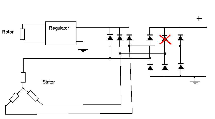

The diode, that I red crossed, died (went to short circuit).
I replaced the diodes and now everything is OK.
What I am trying to understand is what exactely was going on
when the circuit was malfunctioning that made the battery
boil.
Any help is welcome.
Thanks.
This is the old Motorola alternator circuit which hasn't been used since the 1960's. No modern system uses the extra "diode-trio" to feed the Voltage Regulator/Field Excitation. Note that the VR is not sensing the actual battery voltage, but is sensing an "artifical" voltage which is supposed to have some relationship to the battery voltage. The shorted diode confused the VR by reducing the output of the "diode-Trio", causing it to over-excite the alternator. I'll bet this from a boat equipped with a Paris-Rohne alternator...
I would scrap the diode-trio, and connect the VR to the battery bus through the Ignition key-switch, which is the way 99% of the 600million cars in the world do it.
Over-exciting the alternator causes too much current to be sent to the battery. This causes the water in the battery to be seperated into hydrogen and oxygen. It isn't really boiling, it's turning water into gasses.
