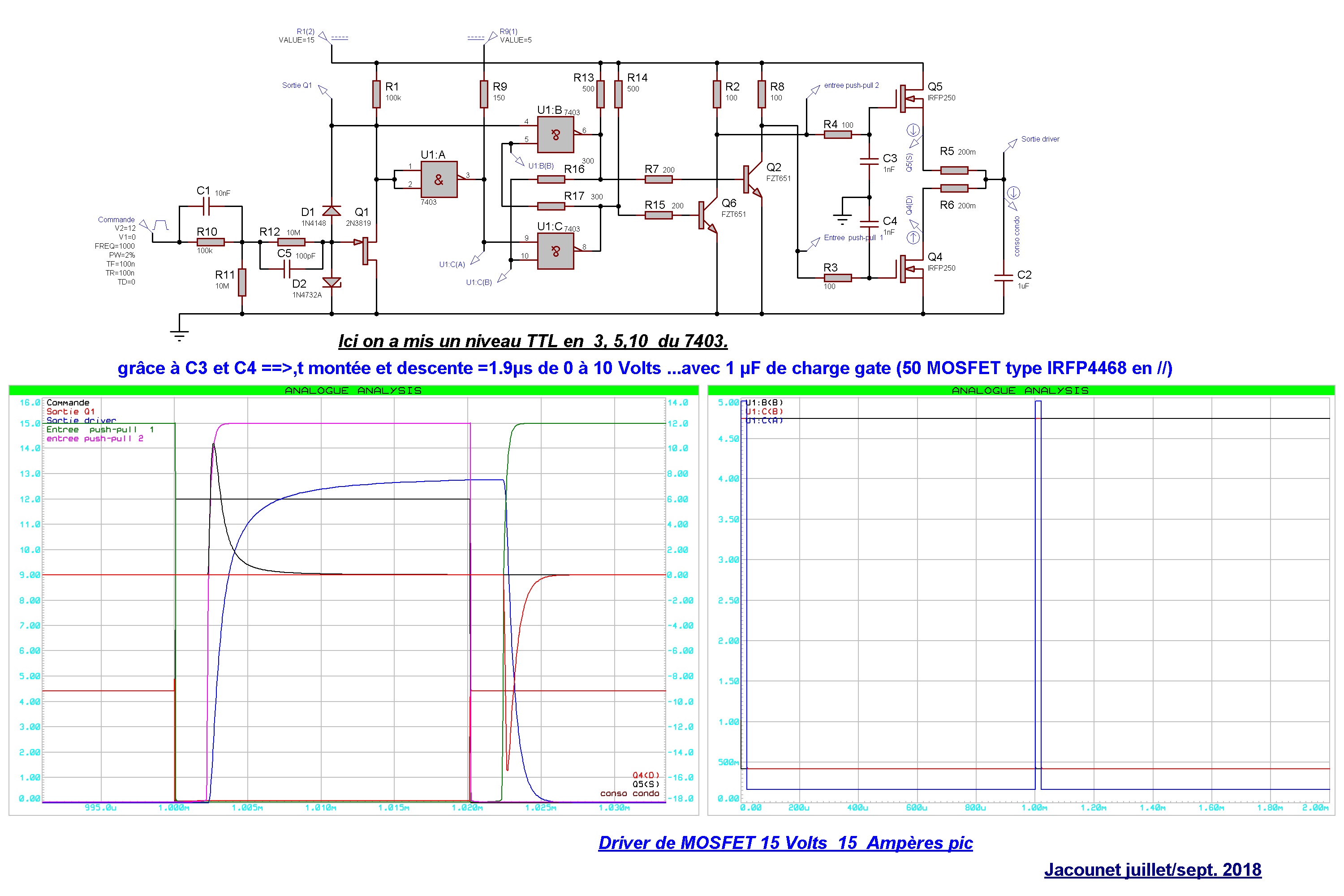

I send sooner my scheme of my driver able to drive current up to 100 Ampères pic for 50 to 100 MOSFET in //...others shemes of my welder prototyp are ( for me ) without interest .
At +
Jac.
Hello.
My driver for MOSFET in // as here simulated With IRF4468... IRF3711 , have the same max current but only with 20 V , V DS ..
Attention , this driver is particular for my prototyp , because of the max dI/dt by MOSFET (100A/µs) the 2 capacitors on the gate get down to the ground , making a t"on" and t "off " of 1.5µs ...it's slow for a driver in Buck or other form cutting power supply under 100 or 200 kHz .
In a normal use this capacitors are in // with the gate résistor .
For a limit rise and slope , the 2 out résistors coming from the MOSFET driver are just Under 1 Ohm ( 0.1 to 0.2 Ohms in my case).
In a normal use for drive quickly ,Under 100ns , these one can be adjust at 10 to 20 mOhms .
By.
Jac.

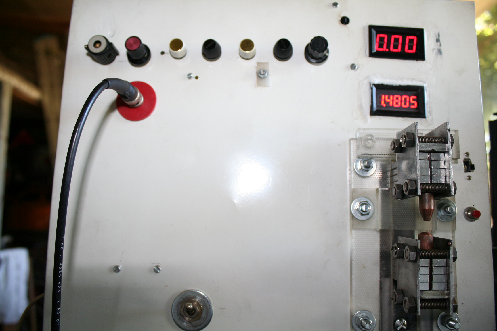

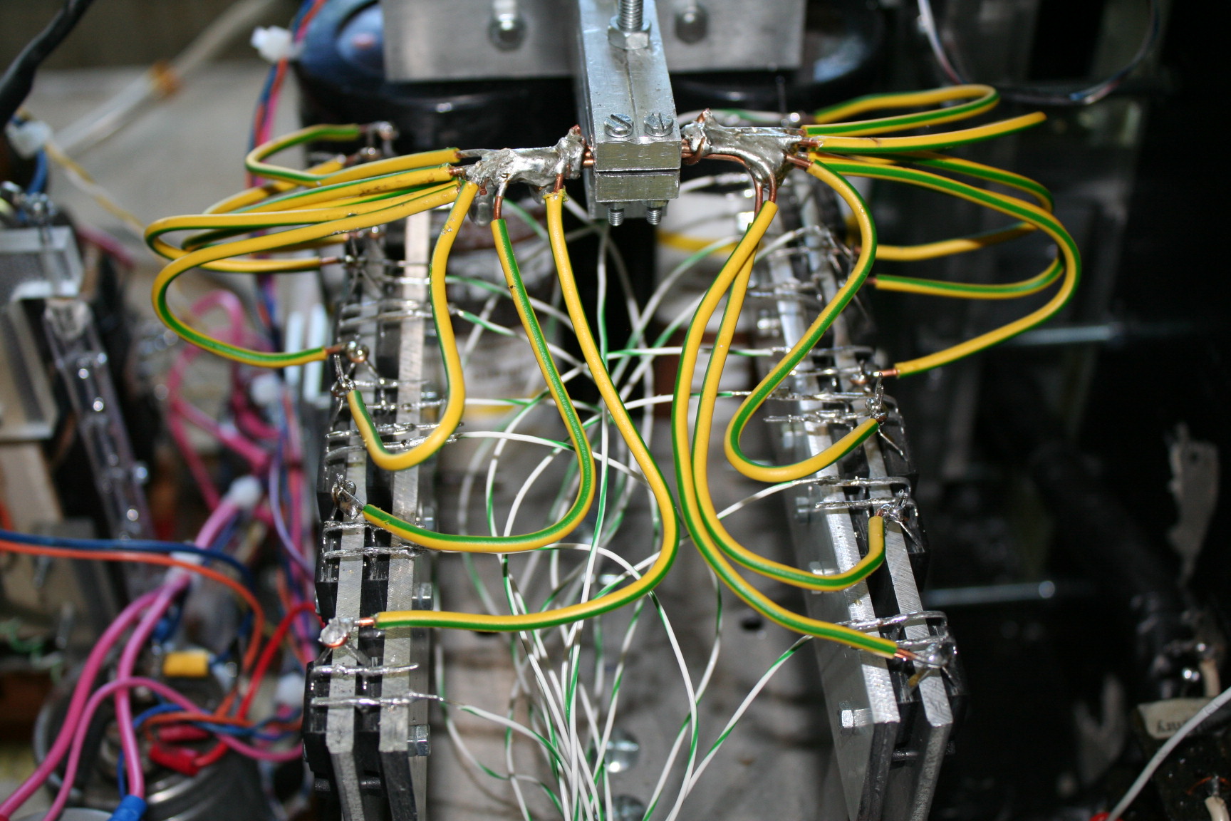

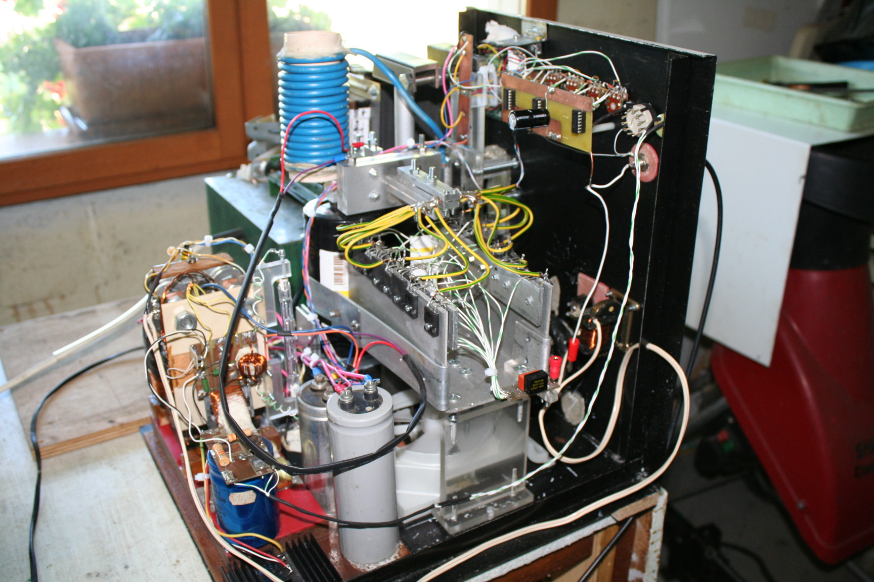

For giving some live for this subject this is some phtography of my prototype .
It was like this last month , Ihave made some change , the blue coil have only one turn now and is only 22 nH ...and I add one resistor of 2 milliOhms in each drain of MOSFET.
The target is to trie to distribute eqally the current in each MOSFET , a detail each MOSFET have a rDS"on" of 5 mOhms .
On face you have 2 digital voltmeters , one for the voltage 0 to 100 Volts ,and one for see the timing of the timer.
It's not a beautiful work but it's a prototype .
Jac .
