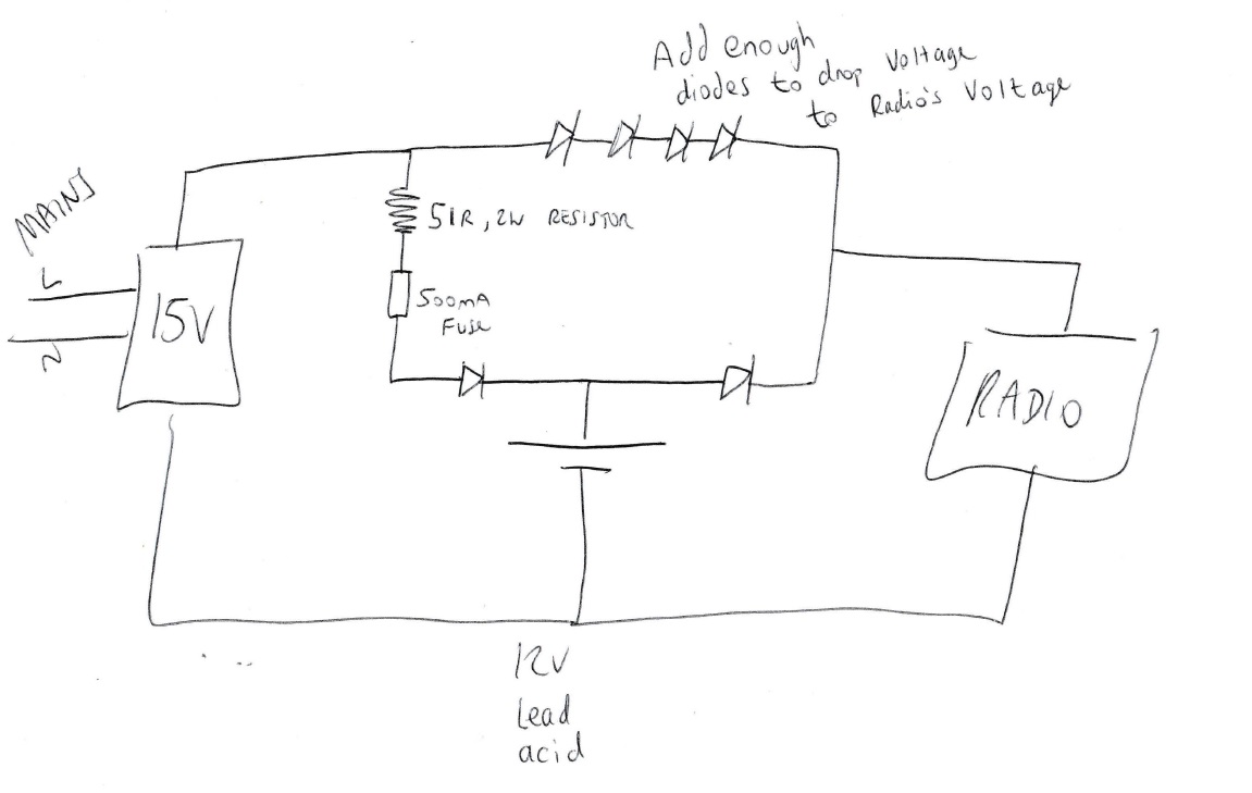

what about this kind of thing..as attached

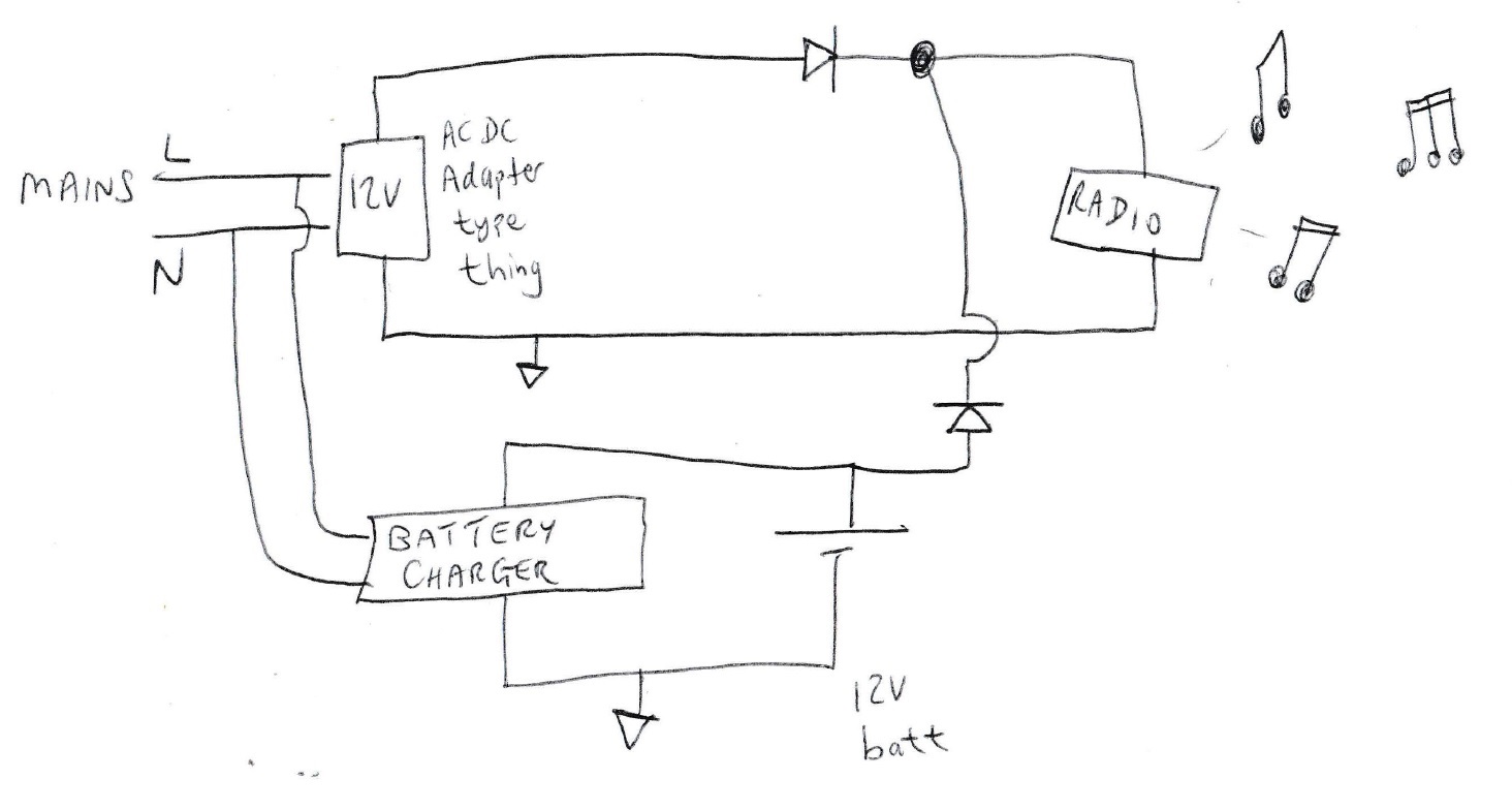

Or there's this one... a little simpler
(actually change the resistor to 100R)
If you connect the ignition input on the radio to the power supply, before the diodes, the radio will turn off when you unplug from the mains.
