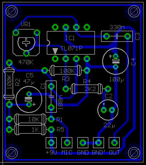

can you have a look at my eagle board layout - the Guru's mic amp

Hi Dan,
taking a glance of your PCB layout I have the impression you must be immensely rich.
Lots of wasted space! PCB manufacturers normally charge according to board size.

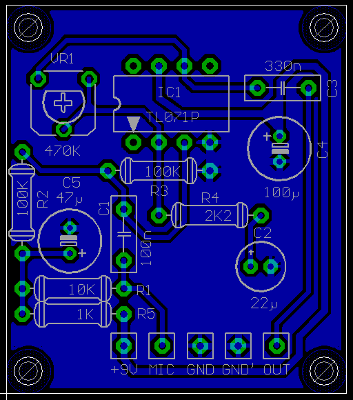

Here is a PCB design according to audioguru's schematic.
It's dimensions are 34X39mm (1.34X1.53inches)
You can reduce size further omitting the ground fill which I do not recommend. AF-amplifiers have the tendency to become radio transmitters. :D

Hi Bon, thanks for posting that up. I wish I was rich haha, but that layout i posted was only a rough one just to make the wiring visable at these early stages
Must have been very early stages! (about 100 years ago). :D
Nobody will object if you try to make a PCB design with least space requirements.
My design was finished within 15 minutes. Trying to squeeze things a bit more I could reduce the board size by 0.2inches on two sides - still having a full ground fill and space for the mounting holes.

lol well thats about the second pcb I've ever designed and the first being a simple led array :)
