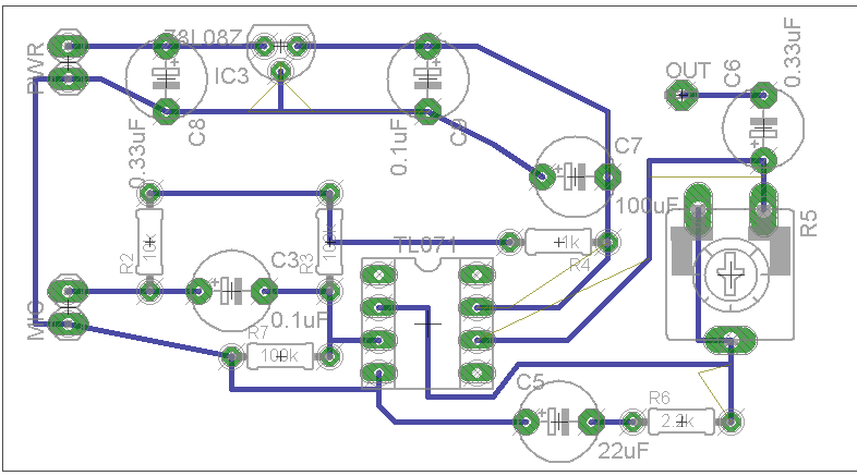

can you have a look at my eagle board layout - the Guru's mic amp
danrogers
basically this will be the first board ive designed other than simple led arrays etc.
could you take a look at how im doing so far and suggest improvement and more importantly re-assure me that it will work :)
thanks

Please post a schematic as well as the PCB layout.
There doesn't appear to be anything wring with the PCB layout.
However I don't know about the schematic because you've drawn the op-amp as a box rather than using the proper symbol.

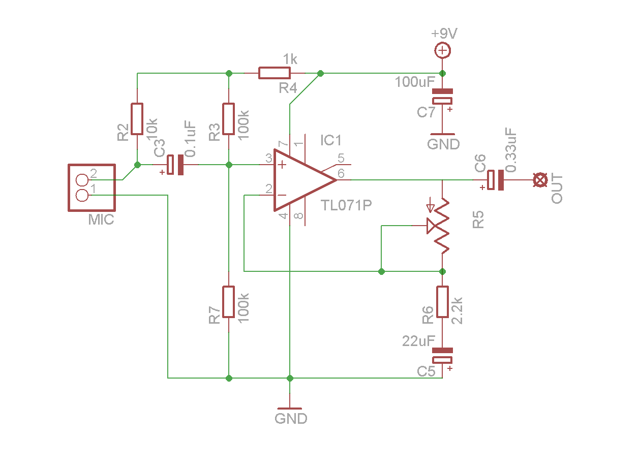

The box is meaningless and it means you need to keep refering to the datasheet, in order for the schematic to make sense. If you use the real op-amp symbol then the schematic will make sense, without having to look at the datasheet and it will be easier to read too.
thats a very good point. I guess ive kind of merged a schematic and a layout diagram and it should obviously be 100% schematic!
thanks for checking :)
is there anything you would suggest to make the board layout look more professional and/or efficient?

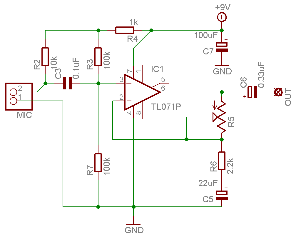

edit.. there we go :)

That's better.
A couple of the capacitors were connected backwards.
C3 was polarised when it should be a non-polarised film capacitor, not ceramic.
I'd also consider making C6 non-polarised or replacing it with a 1µF electrolytic capacitor.

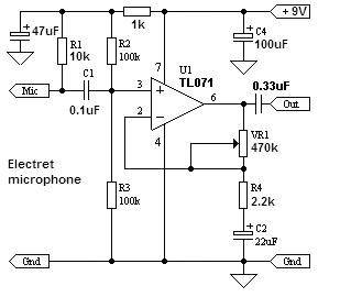

ah yes thanks! I didnt notice that, slightly different symbols.
I guess non- polarised means that electrons can flow from pole to more easier or something?
thanks for the help mate
You are missing the 47uf capacitor to ground at the junction of the 1k and 10k resistors.

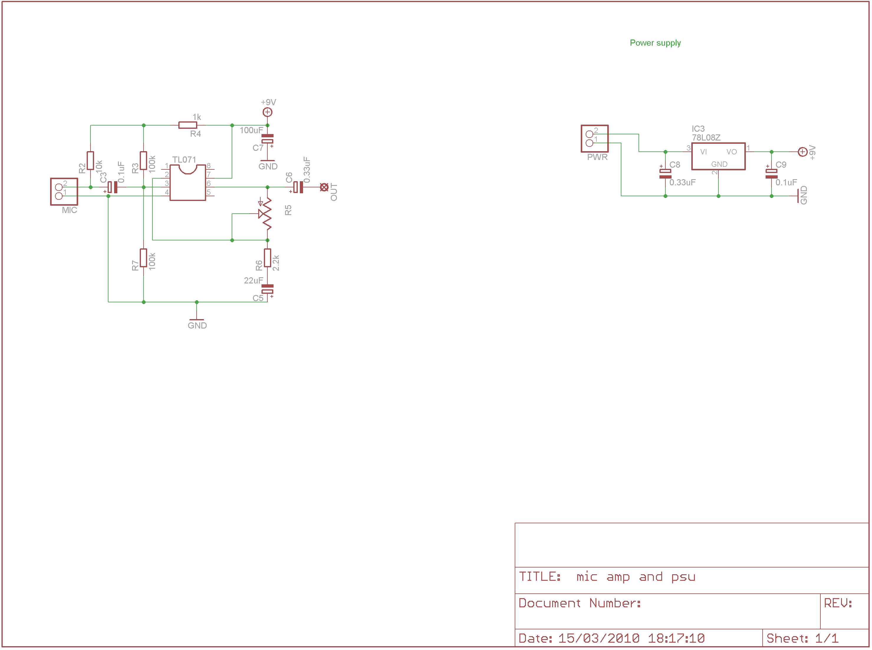

A 78L08 won't work from a 9V battery that drops to 6V. It needs a minimum input of 10V.
The circuit does not need a voltage regulator.
If the output connects to a shielded cable then a 100 ohm series resistor at the output must be used to isolate the capacitance of the cable to avoid oscillation.

Hi Guru,
So in other words i can scrap the regulator and just power from a 9v battery?
Thanks for pointing out the missed cap, I dont know how I missed that.
I have yet to work out the output stage, Im not sure if you remember but I want to use the output to activate a transistor to act as a switch for a RF encoder input. - Thats the next challenge to overcome :)
Hi Guru,
Yes because the regulator's input voltage is too low for it to regulate and all it will do is make the supply to the opamp about 7V without regulation when the battery is new and less when the battery runs down.
The 100uf capacitor filters the battery voltage pretty well.
