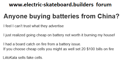

Here is what people on a skakeboard forum say about cheeep Chinese batteries:

When I entered the battery number into Google then I was sent to the electric skateboard forum for my first and never again time.

The "Project Farm" guy on youtube did some serious testing of various 18650 cells with different claimed capacities.
The big name ones (Samsung, LG, Sony, Duracell etc.) typically in the 2.5 - 3.5AH range were all reasonable, the ones with supposedly very high capacities were all fakes with high internal resistance and typically nearer 1AH actual capacity.
