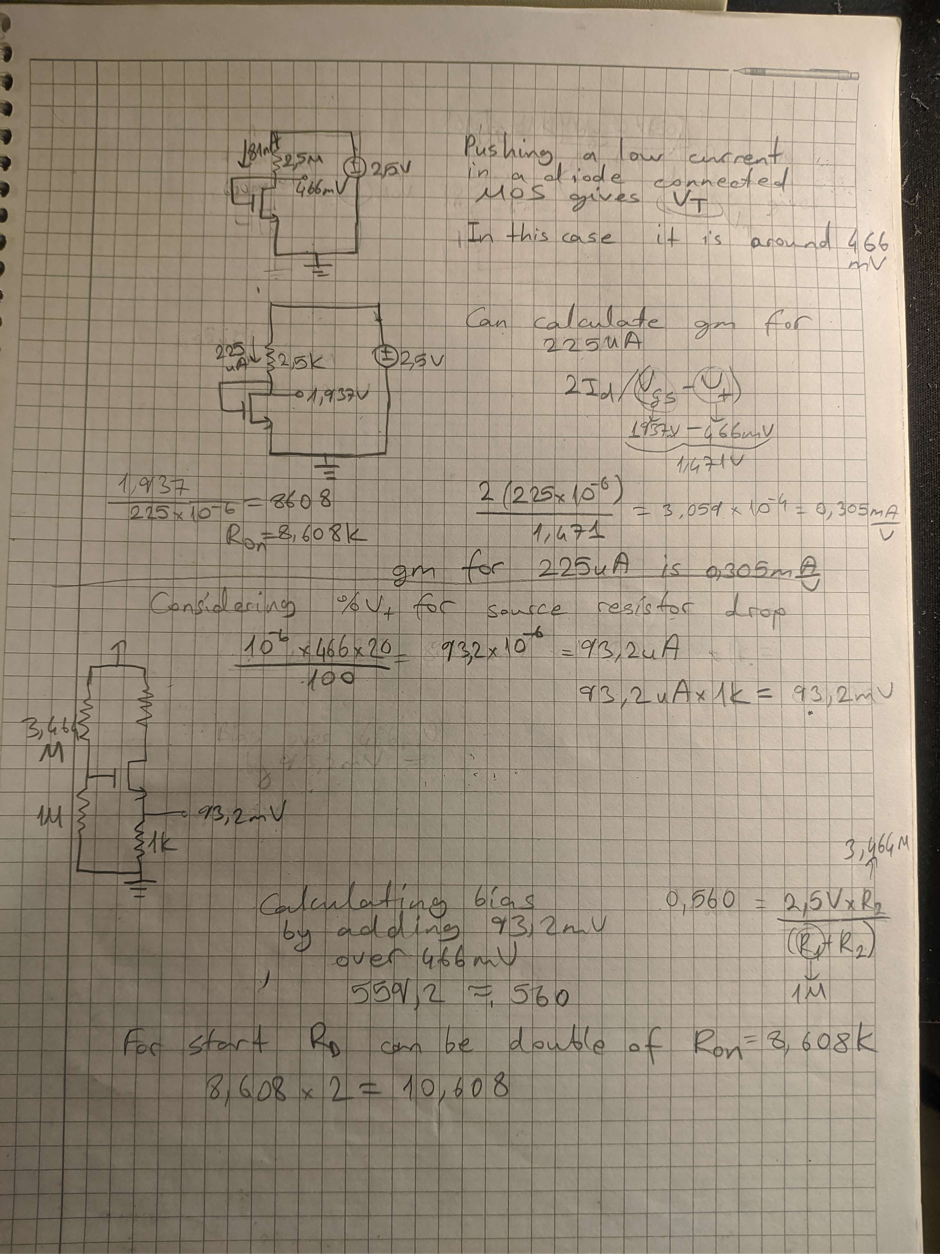

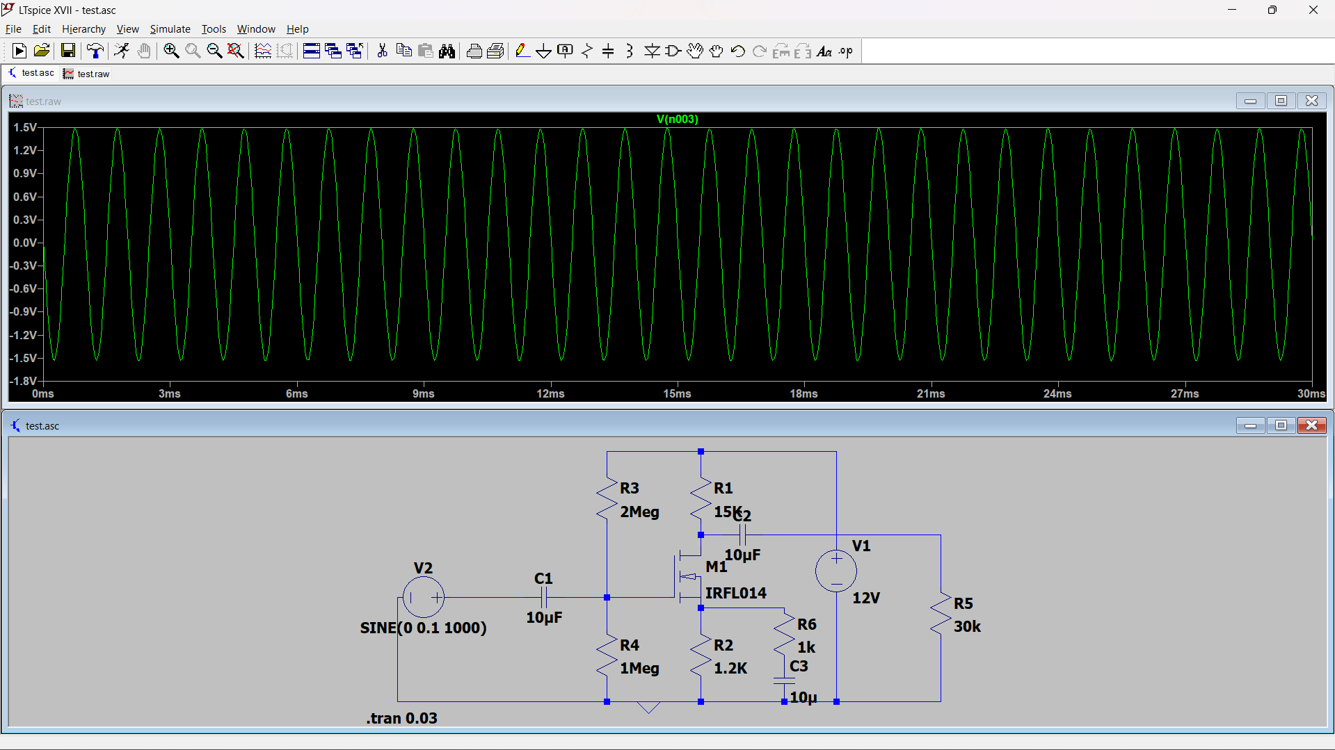

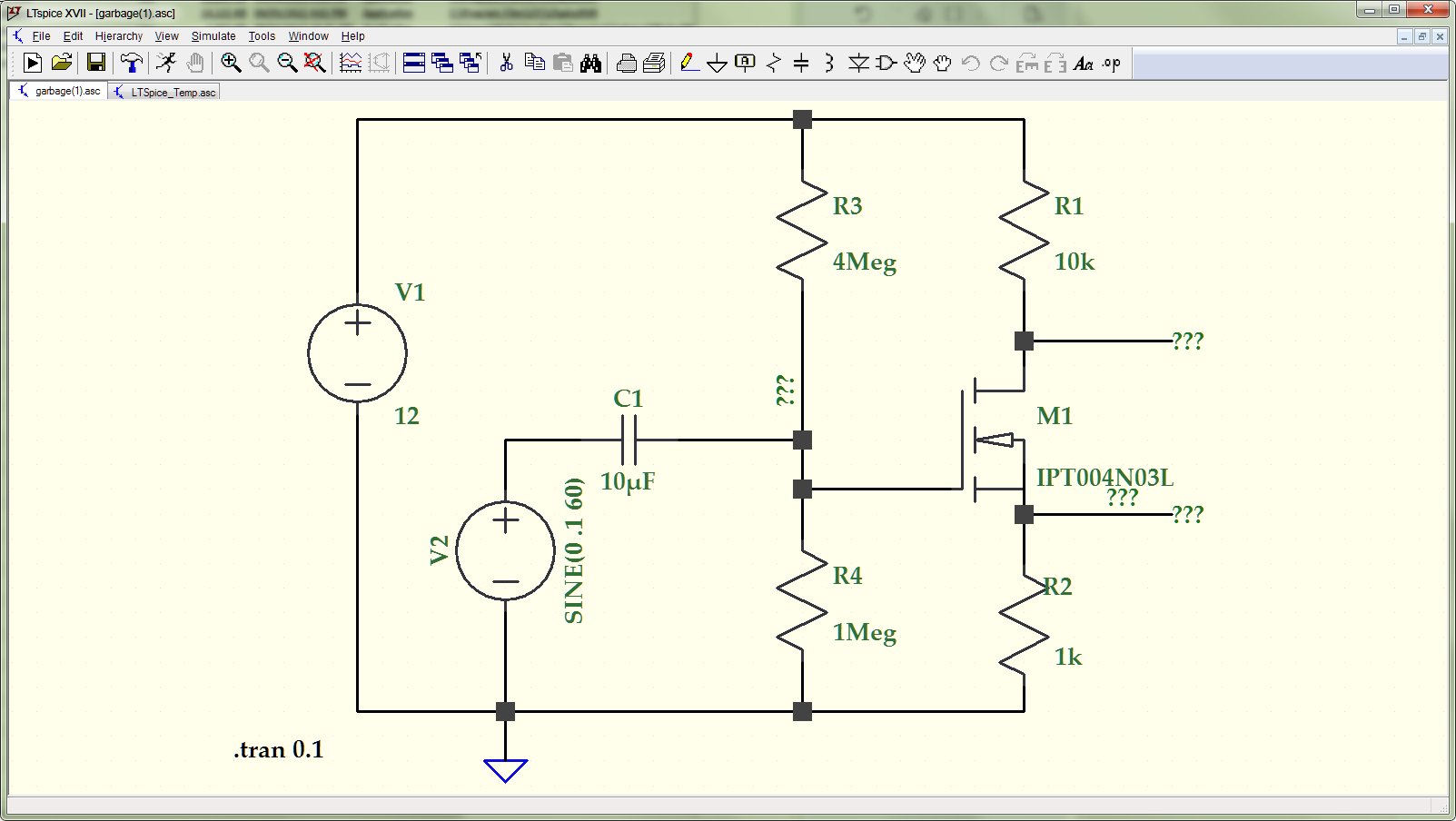

I tried for an hour or so to make a mosfet amplifier in LTspice but I never got gain more than 1 no matter what values I used for bias resistors ,drain resistor, source resistor. If I recall correct gain should be something around -drain resistance/source resistance but nope it just doesn't work.
I need to make a amplifier with 8V/V gain with maximum 2.5Vdrain. I will calculate the values with the boring old fashioned way but it seemed odd that I couldn't get anything working with ballpark values. Cadence also had the same issue so I am assuming I forgot something important. (I tried using more Vd in Cadence later, it didn't help)
  • garbage.asc

Where is the Gate Bias supplied from here?

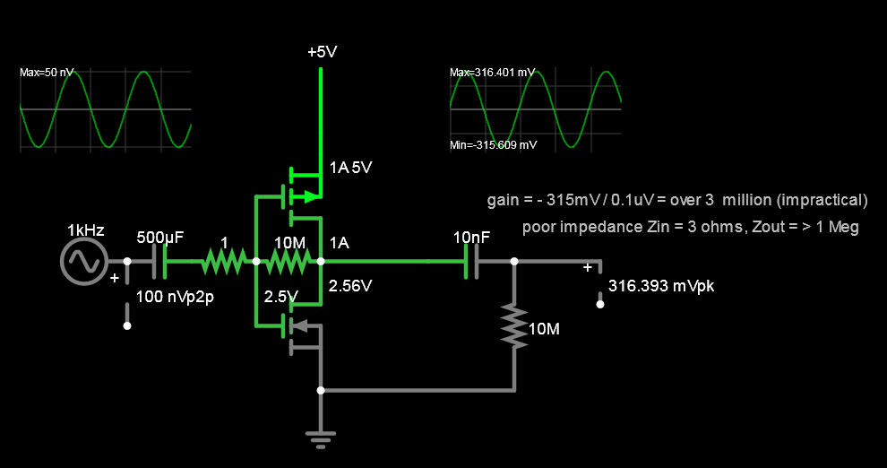

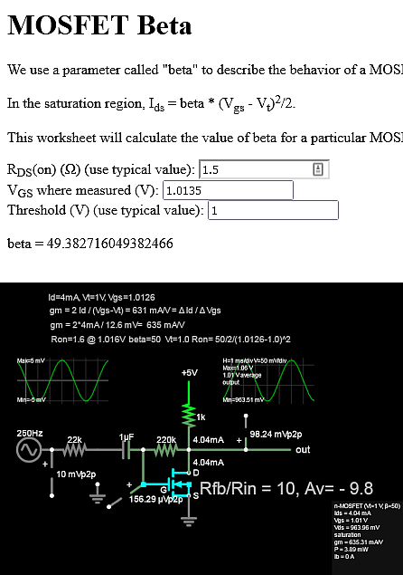

Let me confirm how Falstad's Sim computes gm when you hover over the FET after you choose Vt & Vgs then choose RdsOn with the link and it computes beta so you can finish the design of a closed loop Common Source amplifier that is almost insensitive to gm and Vt and Vgs if you allow a 10% tolerance in gain reduction from drain loading adding to the Rfb value.
Here I chose a FET much like IRLHS6342 but instead of a switch, used it as linear amplifier. This might be a poor design for other reasons, but it proves how to design an AC control gain in Common Source Amp.
You can do the same in LTSpice to see the frequency response effects of Rfb and Qgs=11nF @1V then decide how to improve by matching Z(f) ratios.
Take Away
The bottom line here is you cannot make an accurate gain design with an open loop Common Source FET as you can with a Common Emitter with simple gate voltage biasing due to Vth tolerances.
gm is too sensitive to Vgs-Vt and Vt has too wide a tolerance.
Av=−gm*R(Drain)

But you can simulate the DC and low-frequency characteristics accurately knowing how to use negative feedback. High f (HF) and higher RF demands more experience in geometry and impedance control.
View attachment 139029.
Take Away

For giggles how much gain-bandwidth can you get from a closed loop IRLHS6342 in a Common Source Design at 4 mA drain?

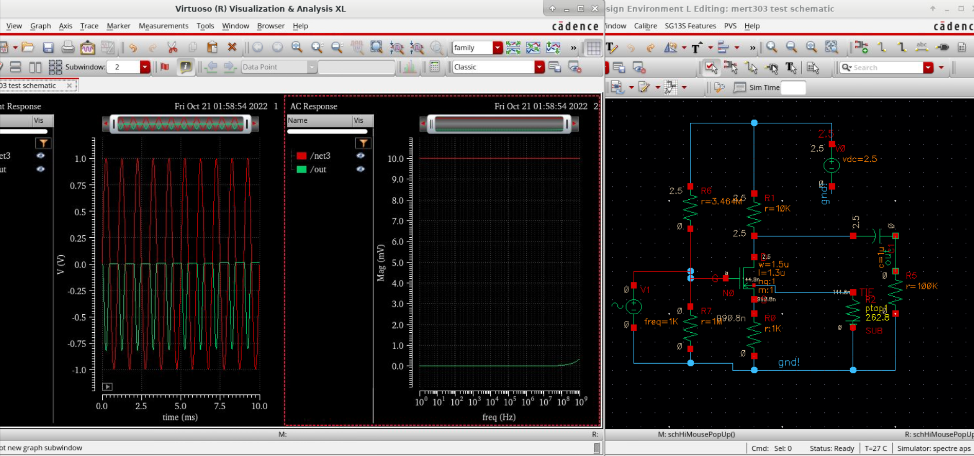

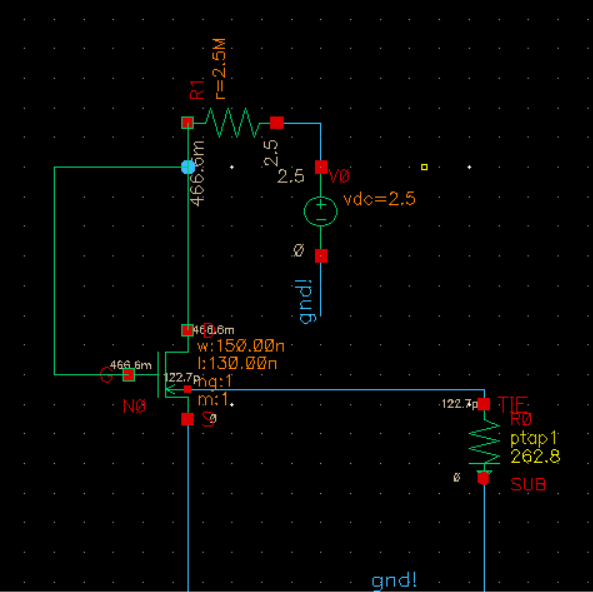

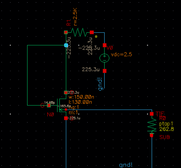

gm I calculated for this mosfet was too low and I think that is why it is impossible to use it for an amplifier. I gave up after working for few hours with no results.

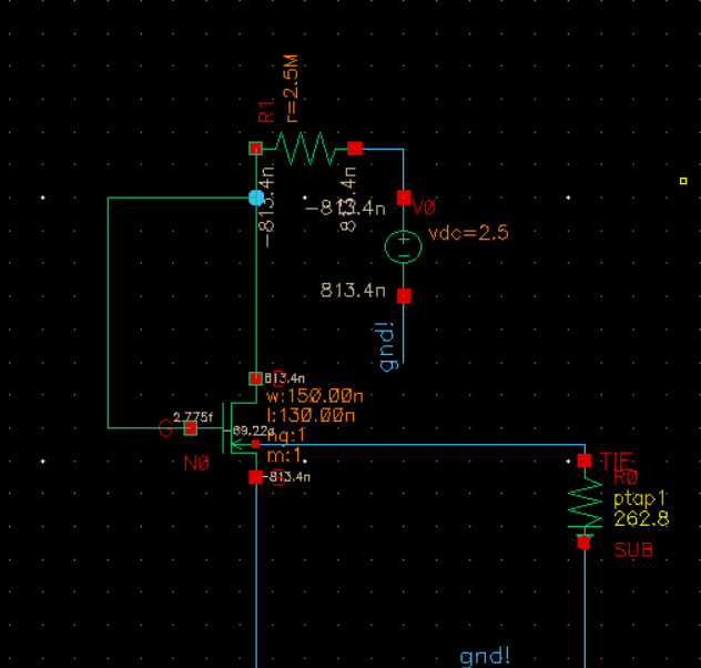

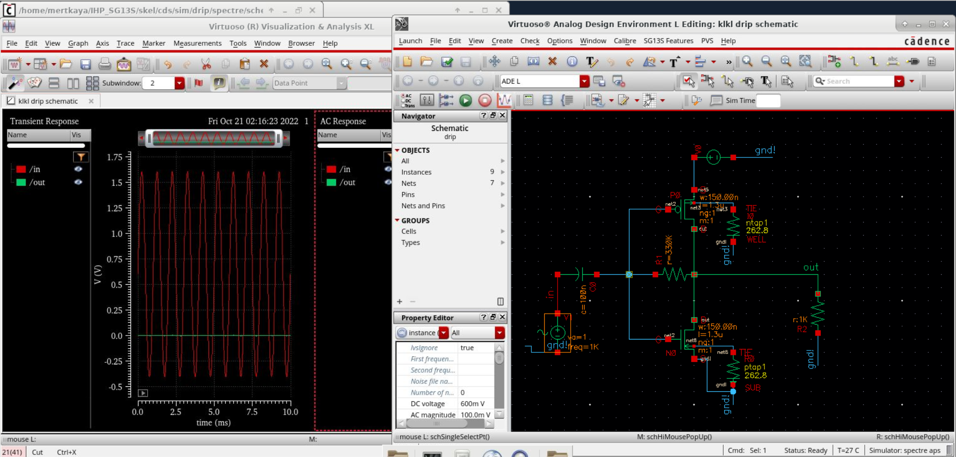

The root cause of gm too low was the excess difference of currents with too low a current for Vt which should’ve been 25 µA. Which resulted in over biasing of Vgs. Had you used the bias for that Vt your gm would be much larger. This is the common threshold for high Rdson parts.
You’ll notice by using negative feedback Vgs is only slightly above Vt which allows for greatest gain with a grounded source and also easy self bias.

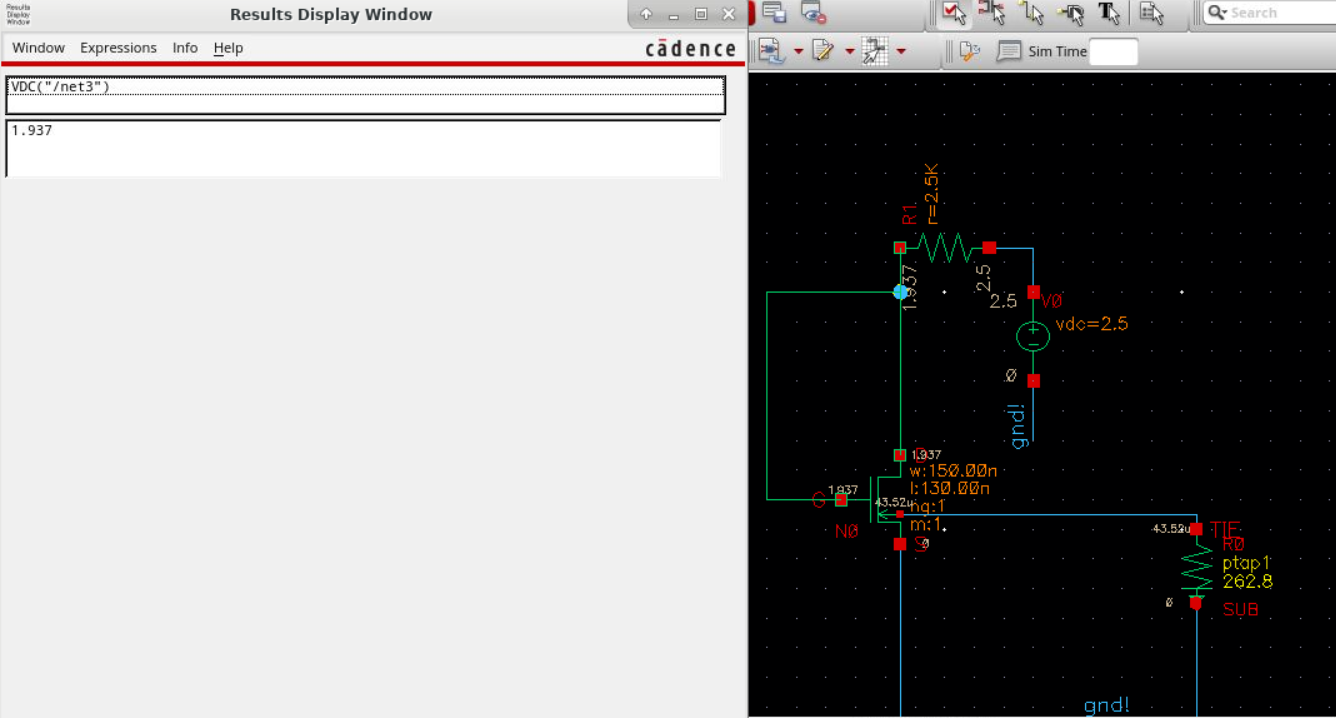

I see. I tried different bias voltages later with no luck after that while keeping Rd 10k and Rs 1k with no luck. I also got rid of bias resistors and tried adding DC offset from the AC source itself to try like 700mV but nope nothing worked. I never got more than 1 times gain. I don't know how to use feedback on transistor amplifiers but I guess I will find that out in the next analog circuit design lecture.
It looks like for 25nA Vt is 0.783V

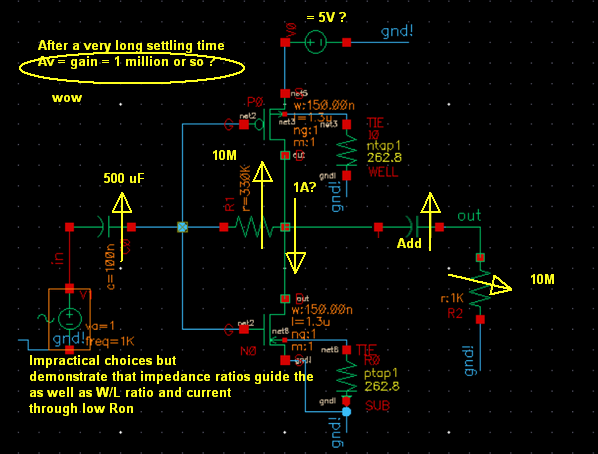

Regarding your Cadence last photo.:
The 1K load was too small a value for the output impedance of the circuit by loading and DC coupled affected Vgs biasing below threshold so impedance ratios prevented any gain
Try this link or in Cadence Beta = 2, Vth= 1.5
Change Values with mouse wheel in Falstad or create slider
When designing analog FETs with high gain use large W/L ratio up to 1200 or so depending on noise effects.
The 1A Falstad example was ridiculous but head-bangs the point that high impedance ratios AC coupled allows for great voltage gain but at the loss in impedance buffer gain of out/in
Review Theory here

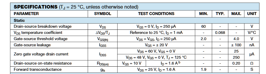

You will find the forward conductance gm in the IRFL014 rated in Siemens is high since Rdson is low as a switch. which I approximated in Falstad sim with beta = 2 but left Vt= 1.5 rather than some value between 2 to 4V

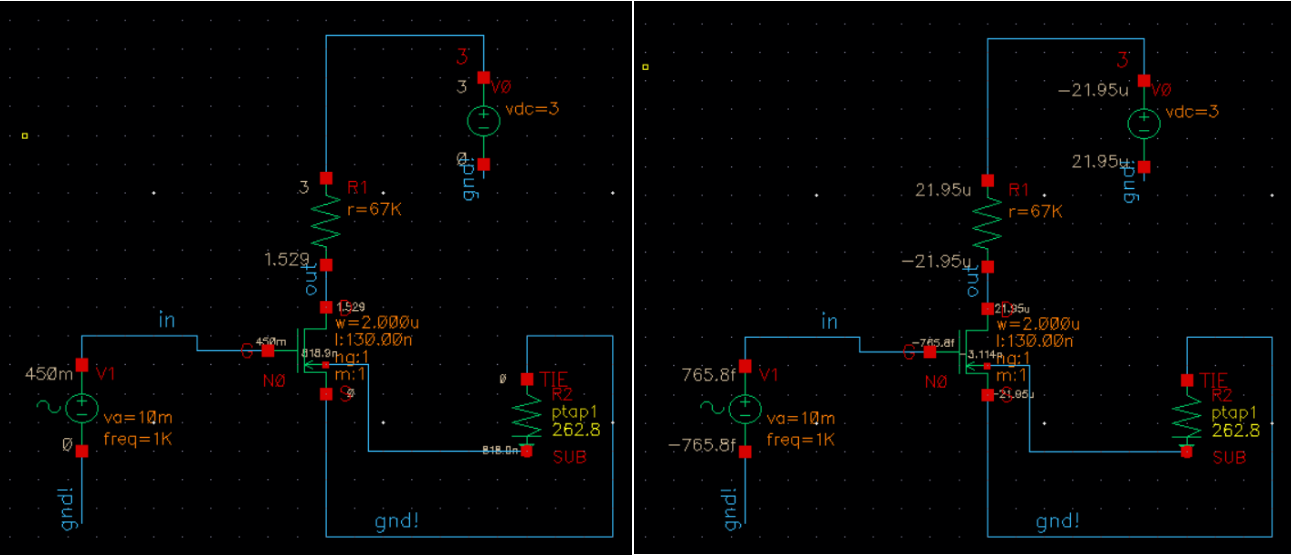

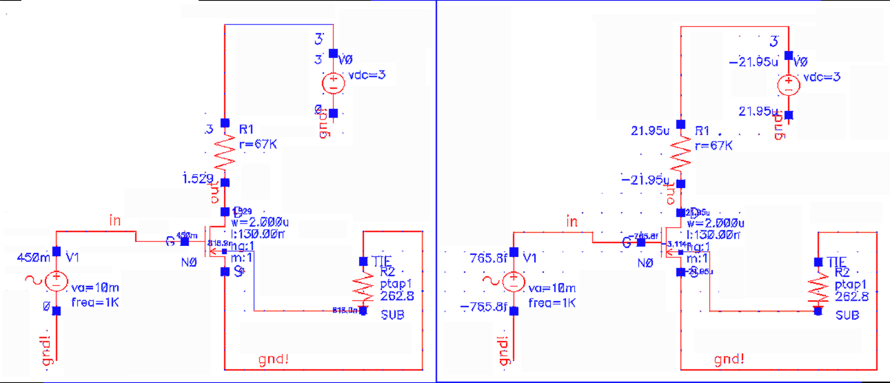

I am leaving this here. I was able to learn using Cadence better while writings this so it is quite messy and problematic report if it can be called that. But I was able to get some stuff working even though my hand calculations always failed me. I will post the layout stuff when its due date is over. I am trying to understand small signal calculations with added second characteristic effects like ro and body effect but it gets quite complicated very quick.
It turns out thermal voltage is all over the place and it keeps making hand calculations useless. Also cut off region gives more gain due to its exponential nature. It is so imperfect that it drives me mad.
I also thought Width of the mosfet would affect gate capacitance and ruin the bandwidth in case it is too much but it turns out it doesn't really effect 3dB point in simulation. Maybe all though put into it is in vain idk.
  • CS amplifier in Cadence.pdf

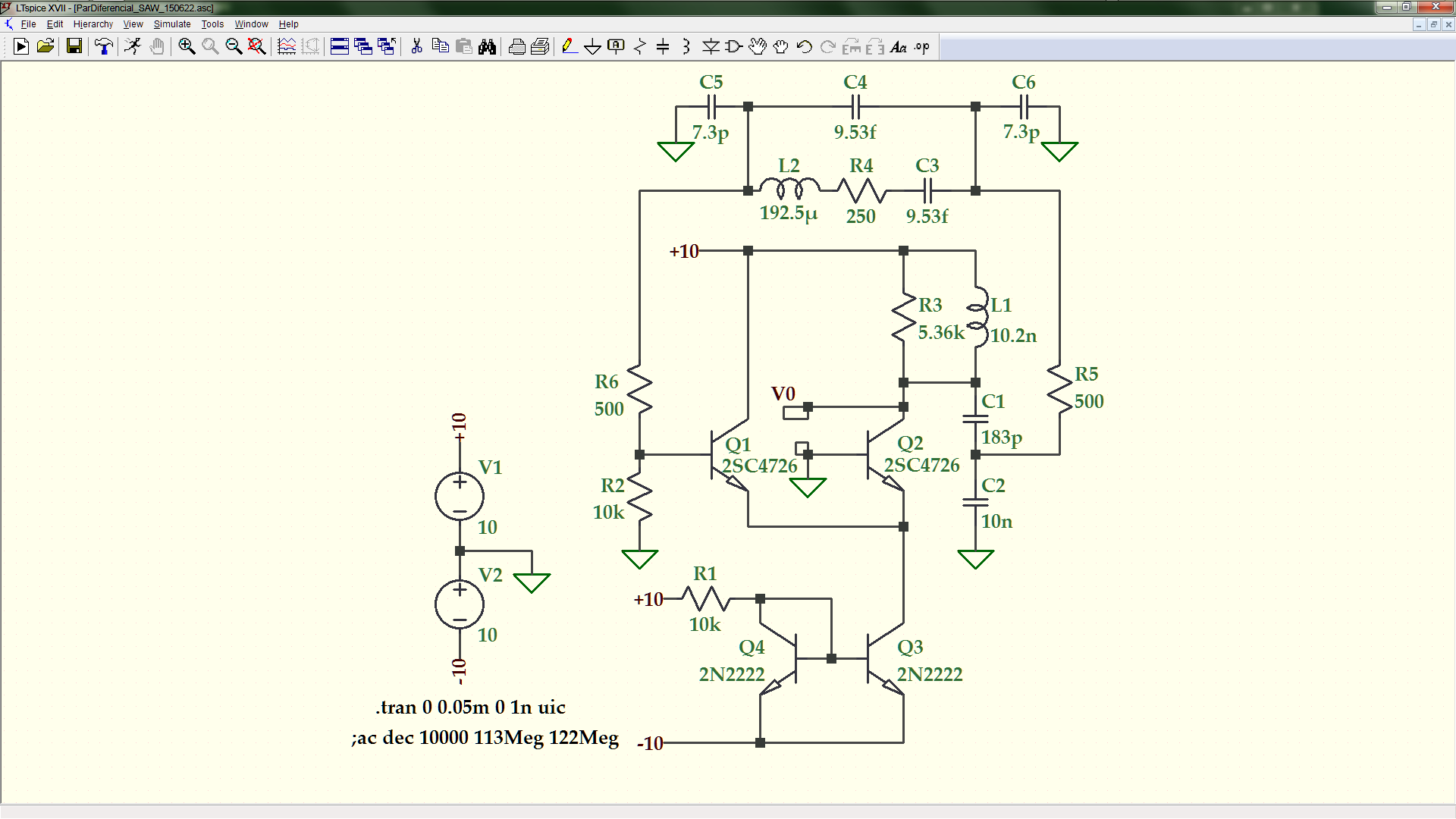

Is that a saw oscillator. I didn't know you could do something without diode and just 4 bjts.
I can name the lines for better understand ability of the circuit as you said but I was a bit lazy and it doesn't make it harder to understand for me but I get the reason why it is not ideal. Level 6 must be very complex I guess I can not really predicts its behaviors without good intuition.
I don't know how to change the background and such in Cadence though, it is a program with a very outdated user interface.

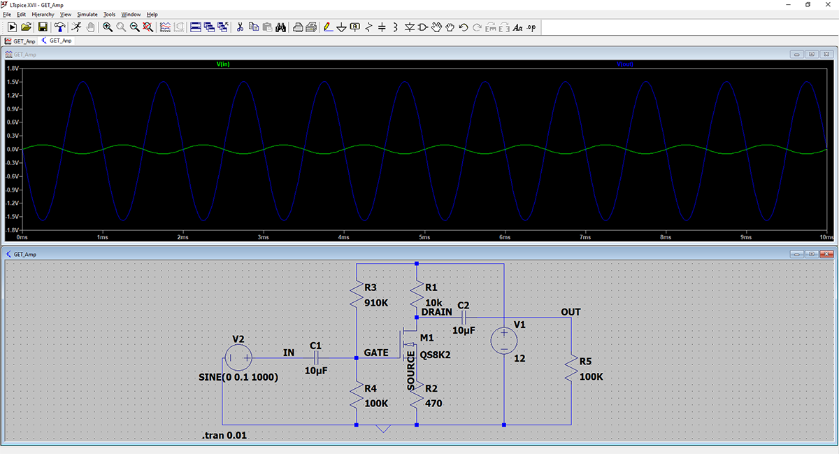

Here's an update of your original ltspice circuit, set up as I described.
Note that the original did not have any connection between the bias resistors and gate!
(The mosfet is just a small signal one I picked at random from the available parts).
  • FET_Amp.asc

Yes my original circuit was garbage because I forgot to connect the bias to gate. The thing with mosfets in Cadence is that their output resistance is low and it is pulling the Rd to a lower value since they are parallel -gmRd becomes -gm(Rd // ro). And bias voltage gets hard to decide because Vt changes with Id. Increasing the Width of the mosfet increases Id and gm but after some point it loses its effect. Because all variables are tangled to each other I can not apply the normal mosfet knowledge I got at advanced electronics class in analog design class. LTSpice simulation just doesn't cut it at that level. Also body effect decreases the effective resistance of the diode connected mosfet and decreasing its equivalent resistance. When I should get 22 times gain I get like 6-10. Considering all that and adjusting the values is to difficult.
You appear to have the source grounded in the Cadence circuit (though it's difficult to make out).
You must have a source resistor to stabilise the bias and device current.
I don't have cadence so I cannot do anything with that circuit.
Yes I Rs would make it more linear and stop gain from being dependent on gm but teacher asked for 10 gain which was impossible to have with source resistance since it decreases gain.

All Spice based simulators are likely quit similar in their accuracy but, I think Falstad uses a different and simpler simulation engine, so I would not expect it to be as accurate.
