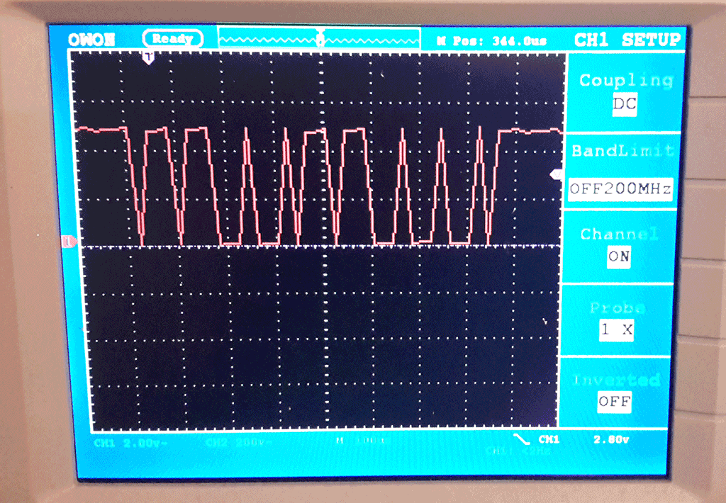

I have a pic project that I was attempting to add a TM1637. It wan't working and I ended up putting the scope on the clock and data lines. The clock line had additional clocks than it should have had. As I had various other bits of code and after much head scratching, I started a new project with just the following code,

This is what I see on the scope.

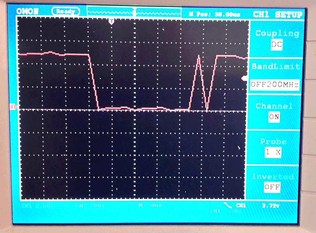

The timebase is 50uS.
If the delay is shorted to 50uS I see this,
I started with a 16F18346 and then changed to a 16F18446 but it made no difference.
I've powered it from PK4 and a separate power supply - no difference.
WDT is off.
The scope has a 1kHz output which it shows as a perfect square wave.
Anyone any ideas what might cause this?
I'm hoping I've done something really stupid so I can get on with this.

Didn't it speed up the rise and fall?. I'm presuming your scope is fast enough? - in my experience SLR ON gives the sloping sides like yours, and SLR OFF restores the normal square sides. With SLR ON you get issues with SPI etc.
I see you're only running it once, if you place the high/low lines at the end in a continuous looop what happens?.
I originally had it in a for loop repeating 8 times and got this,
This was with this code,

Note the loop is 8 iterations and the scope shows 10 dips!!! Some wide, some narrow. There is no other code. I'm completely stumped. I even disassembled the code just in case!!!

I would put a longer delay between the TRISB4=0 and the FOR commands. That would rule out any strange behavior of the registers while you initialize them.
Also, to my eyeballs, I see pairs of spikes, 2 of each for the start until the last one, which does not match the pattern. I see 2 high, 2 low, 2 high, 2 low and then a single low. Strange pattern, but it may mean something...
EDIT: What happens if you make the 10k a pull-down instead of pull-up. Is the pattern similar?

I used the 446 for a project at work - and fell foul of the SLR problem, utilising the scope (just like Pommie) showed the same sloping sides, and a little datasheet reading found the SLR was ON by default.
Pommie - have you tried using a different I/O pin, to confirm it's not some peripheral that's using the pin?.
