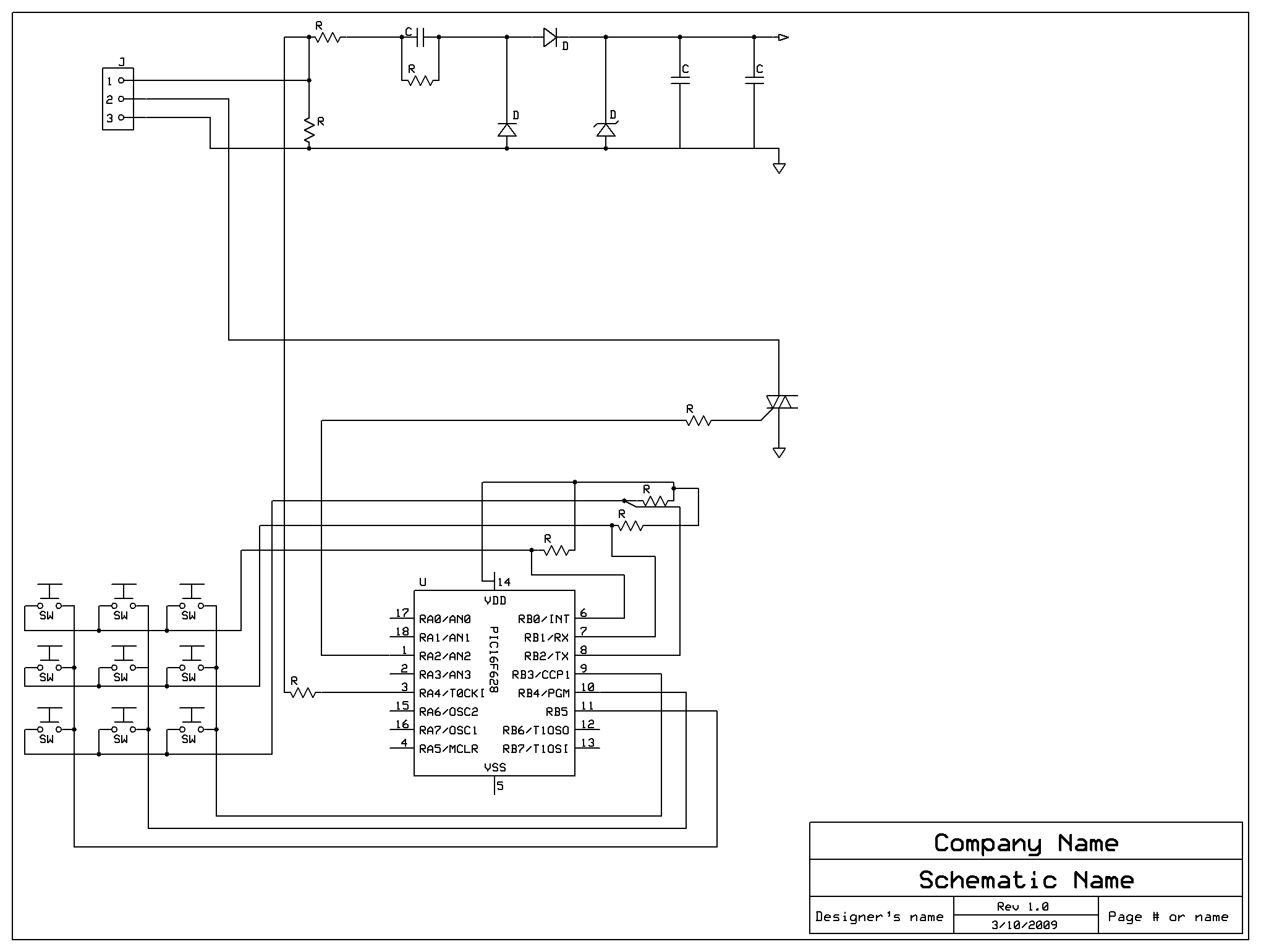

Calling all programming heads
No That why I said get a bigger pic
Ok cuz i was told i might need one, so now i will go ahead and order the chip i see ur an ebay seller u selling any?lol
also how can the program portion be tweaked to achieve want i want to do?

Here a start for the key pad it not done need to add what the Keys going to do when pressed

Put some pullups on a keyboard row. Keeps you from shorting outputs when you're scanning and someone presses more than one button at a time.
__________________
Bill
Smart Kits build Smart People
blueroomelectronics - Smart Kits Build Smart People
Now I know Bill and and I know you can short the output when scanning more them 1 button at a time . It is to easy to turn off a pullups. So she will stay as is.
How does a short occur when you are scanning? You must be scanning incorrectly.
All that happens when 2 keys are pressed is this: The program picks up the first key in the sequence.
Are you having a bad day or what. You just said don't use pullups. Set the pins to use
internal 47k pull-up resistors
Then you say
I am a teacher and students will get completely lost unless it is absolutely understandable
now it is a lot easier to use a pullups then to turn it on internally.
I posted the wrong 1 here the right 1 I didn't put pullups in it at first and when I posted it here what you need to go with but I still need to added 1 more row of keys.
