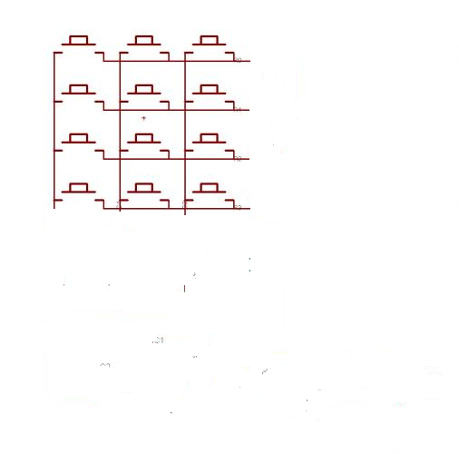

Mr.K If you would post what your trying to do here and stop Pm me. I'll do my best to help
you with it. Now
1. If you want to make a dimmer post the circuit or a link to it
2. If your dimmer is to use something like a sony remote you can use the 12F675
3. If it is to have a key pad then you need a bigger chip because of the key pad now you can use a 16f628a lot's of code that you can look at a learn by. Me my self I would use a 18f1230 I like basic and Assembly don't do much in C the 18F you can use swordfish basic
4. If you want help the form is where it at now I -know you think people are not willing to help that's not so they wouldn't be on here.
Post your code or a link to it here something like this

Now down load the circuit for the keypad add your pic and dimmer control to it and let's get started pick'n

Put some pullups on a keyboard row. Keeps you from shorting outputs when you're scanning and someone presses more than one button at a time.
I wasn't done I was just trying to help him out I was going to put 3 10k on it and when I get time I'll add the part value.

Sure :D like I mentioned in the pm, I want to make a modification to this hobby project
-My plan is to take out the IR stuff because it's controlled by IR and modify it. My Goal is to have the light dimmer be controlled by a 3x4 keypad. I have already order the parts from the schematic above minus the chip and the IR stuff. Here is how I want the chip to tell the keypad how to operate
When power is first turned on press “*” and enter a four digit default code; such as, “0000”.
-The light will begin to function.
- To change the code press “#” input the old code followed with a new four digit code sequence.
- New code sequence is accepted and must be used to allow the light to
function.
- Increasing brightness of the light will be controlled by pressing “2”.
-Decreasing brightness of the light will be controlled by pressing “8”
- After 30 seconds the user can not change the brightness with the “2” or “8” key. The selected code sequence must be re-entered.
-When the power goes off the default code will be set back to 0000
I like the schematic B! However I don't know which circuit better suites what im trying to do. Take a look at the **broken link removed** Im making the modification too and tell me what you think
It's more or less the same I just added A keypad
