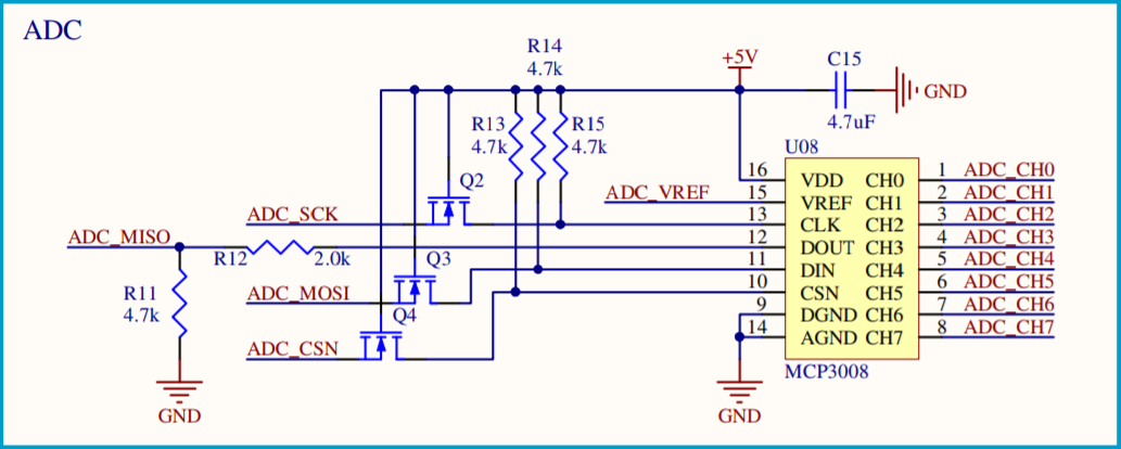

I'm still trying to figure out the level shifting they use for the ADC SPI connection. They supply the ADC chip with 5V and I expect the SPI signals to be ~4V, and I see a few FETs and resistors but they seem to be missing a set of resistors on the LV side (not to mention I would have expected the gate of the NFET to connect to the LV side as well not the HV side). What am I missing here?
Normally, you hold the source constant and apply a changing gate voltage to modulate Vgs to turn the FET on and off. In this case, they are modulating Vgs by holding the gate constant and applying a changing voltage to the source.
Basically, the MOSFET is wired to be an ideal diode that allows current in the line to flow from the ADC to the FPGA. Therefore the FPGA can only ever directly drive the voltage at the ADC pin low. Whenever it tries to drive it high, the ideal diode blocks from getting to the ADC pin which makes the ADC pin high impedance, but then the pull-up resistor takes over and applies the appropriate logic high voltage to the ADC pin.
You can manipulate Vgs by fixing the source voltage and manipulating the gate voltage, which is what is usually done. In this case, they are fixing the gate voltage and manipulating the source voltage. In either case, you can make Vgs = 0V to turn it off, or Vgs = 5V to turn it on. That's how an ideal diode works. If the gate is fixed at 5V, driving the source to a sufficient positive voltage will make Vgs small and turn the MOSFET off and block the source voltage/signal from reaching the drain, while driving the source low will increase Vgs and turn the MOSFET on and allow the source voltage/signal/current to pass to the drain.
The level shifting method you have in mind where the NFET is on the low-side and a pull-up on the high-side has the problem of inverting the signal.
