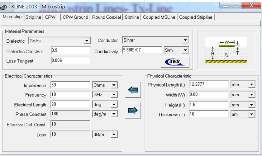

Hello,
I need to calculate minimum coupling between two microstrip line and the gap required for this, how do i do this?
is there any tool?
hoping for reply
ramesh
Re
thanks for link, but no good. I needed gap distance between two microstrip on the same plane i.e horizontal. the calculators in the link calculates only vertical.

I want to calculate gap distance required between two microstrip for minimum effects on each other, which i believe is the term coupling.
There are so much advanced formulation in textbooks regarding this problem and the topic is broad itself, so I wanted to ask designers here what formula is used in my case.
Microwave frequencies have their own set of rules. I have no experience there. The only thing I would think is further apart is less coupling. :rolleyes:
Minimum coupling between two micro strip lines and the gap required for this, coupling theory, Micro strip coupled transmission lines have been studied extensively for applications as couplers and filter. I have attached necessary Pdf about Microstrip.
