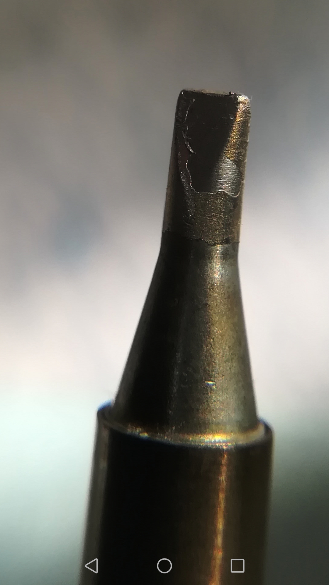

Recently i've noticed that my favorite soldering iron tip, peeled off a little and since it's hard to find locally,
i decided to go to a shop which anodises metals and ask for a new cadmium coating.
I was in front watching the procedure, the guy covered with electric tape the part that shouldn't
get coated placed a wire around the tip and deeped it into the water to do the electroplating,
after around 5 minutes it was done he transfered the tip to another machine which looked like
a barel (don't know what that is... i guess it stabilizes the coating with heat or pressure?) for around
one minute and then he gave the tip to me.
problem is when i tried to use the tip, it started to peel off again this time right away! and i wonder what
went wrong? is it possible he used non cadmium coating? because he asked me "why we should use cadmium
and not tin?" (he initially didn't understood he was holding a soldering iron tip!!!)

if the iron and nickel layers are compromised, re-plating isn't going to help. in fact what often happens is you get a small hole or crack in the plating, then oxygen begins corroding the copper core, and soon after, you go to solder something, and the iron plating crumples like a piece of tinfoil....
cadmium is one of the last things you want in contact with solder as it can badly effect the way solder flows. https://www.kester.com/Portals/0/Documents/Knowledge Base/EffectsofMetallicImpurities.pdf

You can see the exact condition of the tip in the photo.

Guys just one thing i wanna now, despite the cadmium coating was wrong...do you think it was normal it didn't lasted
not even a single soldering?? i wanna know that because still it's metal coating and it was done with electroplating.

As to why the new cadmium plating did not stick to the tip?
Who knows?
What preparation was done to the tip prior to plating?
It is usual to go through several stages of cleaning and preparation before electroplating.
Was that done in this case?
Or did the guy just do a half hearted job so that he could go back to doing something more important (to him).

No prepation at all! he just did what i describe in the first post...
i don't have knowledge on metallurgy, just now i'm searching details just because of the issue and i think he
had to remove the old coating and then deep the tip into hydrochloric acid before electroplating it.
so as i said earlier that's the reason i care to know if the cadmium coating should last or it peeled off
because he didn't cared to do proper work.

it peeled off because it has a melting point of 321 deg C, and most solder melts between 350-400 deg C, so cadmium isn't something you would want for a coating on a soldering iron
