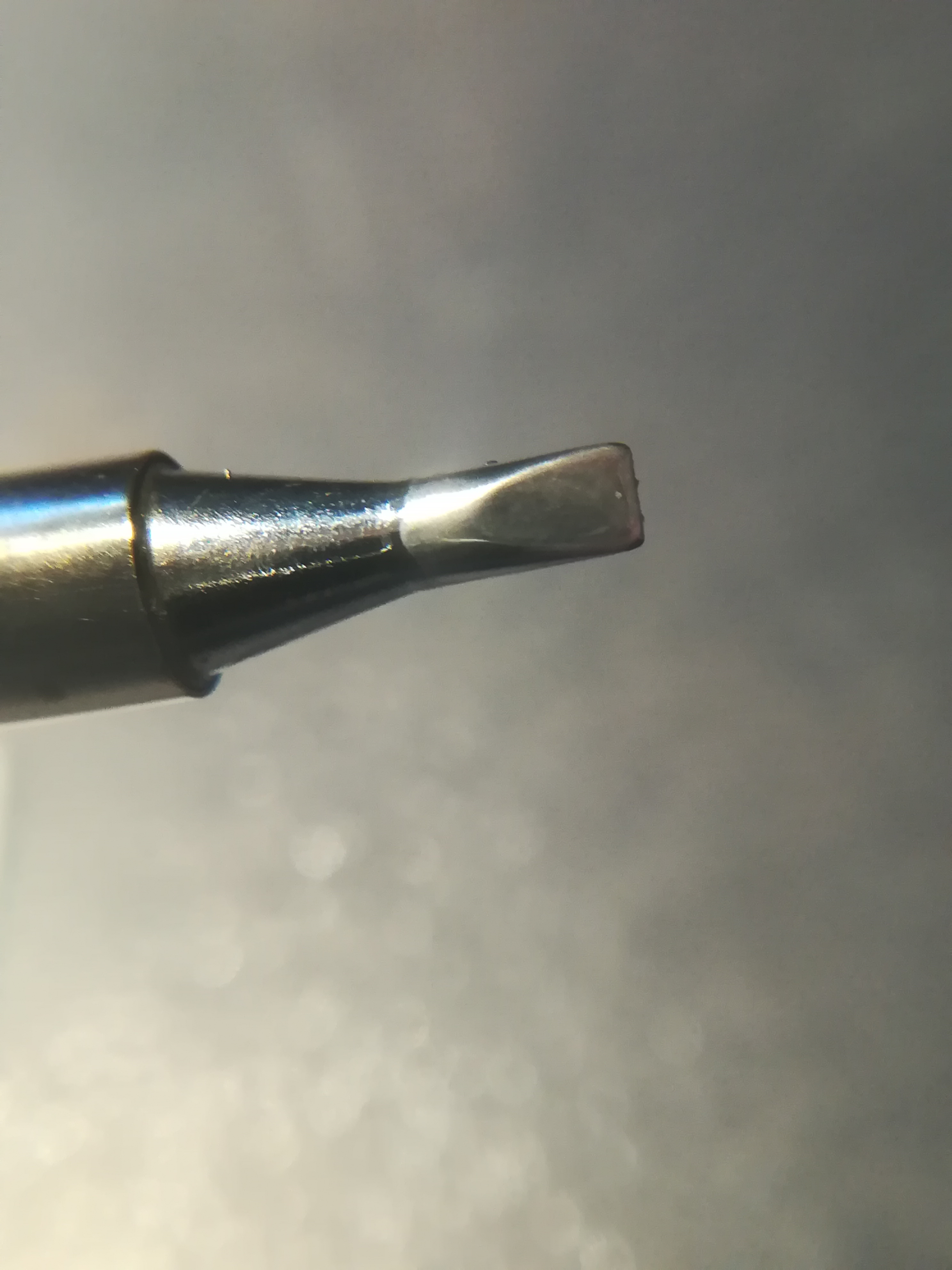

cadmium coating - i got fooled?
it peeled off because it has a melting point of 321 deg C, and most solder melts between 350-400 deg C, so cadmium isn't something you would want for a coating on a soldering iron
true... that's one more good reason.
i can't believe i went to cadmium coat the soldering iron tip!..

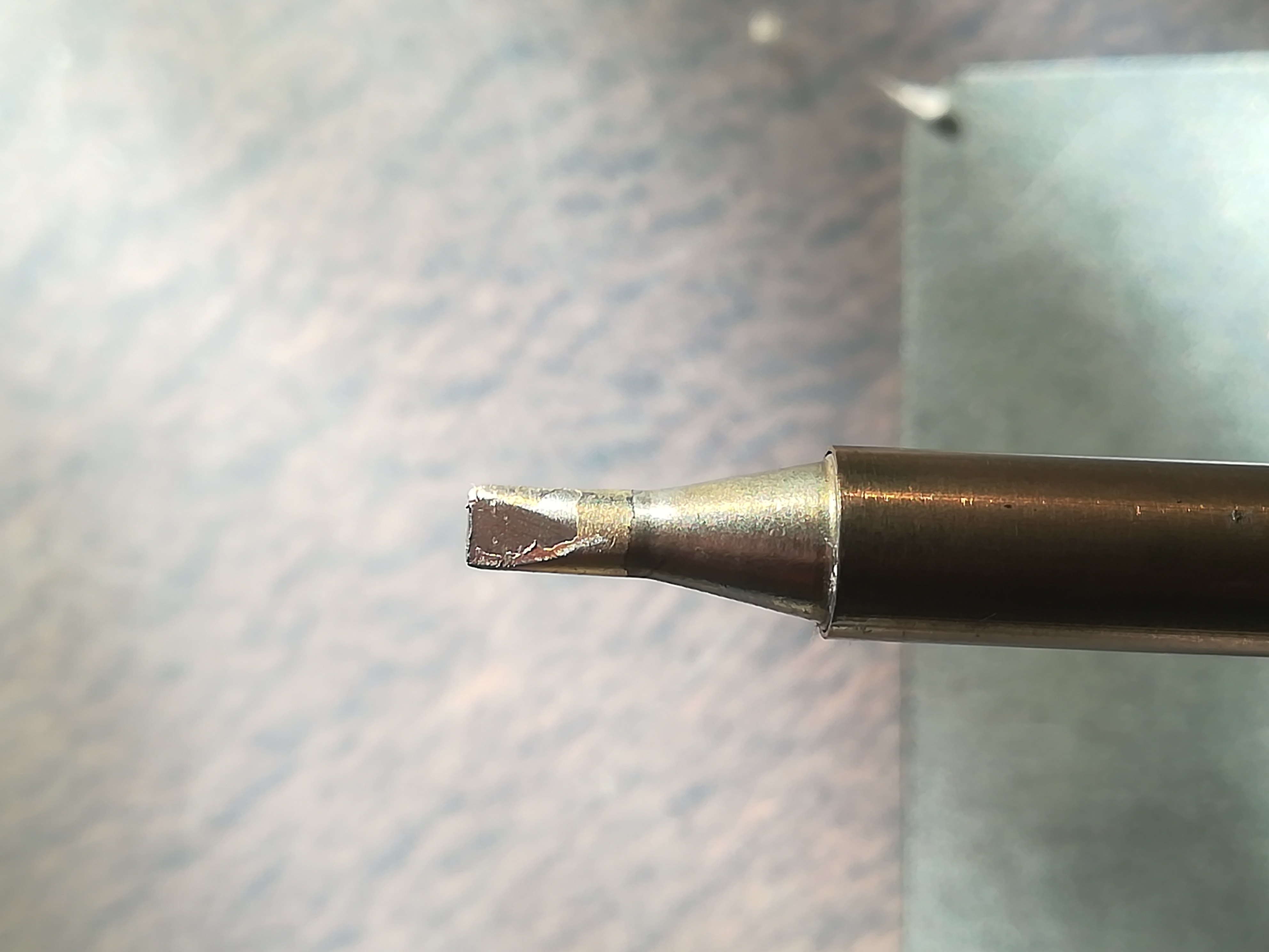

it's ok!
a little earlier i found this useful article from hakko that answered all of my questions
so i went right away and corrected the problem! you can see in the photos
how the tip was before the cadmium coating and how it is now that we removed the cadmium
and we iron plated it.
thank you guys your opinions were also helpful!! :)
fact is...you cannot throw to the garbage a 17 euro tip just because of the coating at the edge
and i guess it costs so much because it's all in one heating element and temperature sensor,
i think it is called "direct heat type" it's not just a soldering bit like some Weller stations have.
