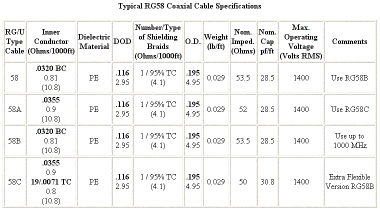

Any one knows the differences between these 2 parts.
RG58AU and RG58BU, what's the meaning of "A" & "B" and "U"?
Pls advise.
Maybe help...
