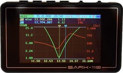

You can use an SWR (standing wave ratio) meter to check matching in a transmitter antenna, or an impedance (or antenna) analyser to check any antenna etc.
With mismatches, the effect is a changing impedance that increases and decreases (or vice versa) over multiples of the signal wavelength in that particular cable (actual wavelength * velocity factor).
