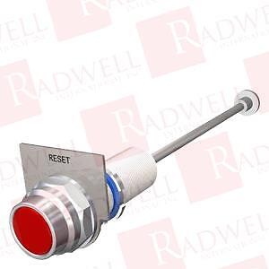

The typical "official" names are such as an "Extended reset operator", but the industrial parts tend to have ludicrous prices!

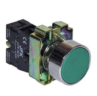

I'd look for some form of modular pushbutton (that has interchangeable contact assemblies) and add your own plastic rod extension to it, something like one of these:
Unscrew the contact block and you have a smart looking button you can attach an extension to.
