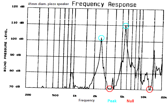

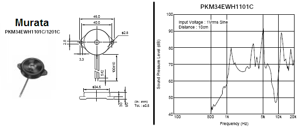

A piezo is made as a beeper with a built-in oscillator or as a transducer (speaker). A piezo transducer has a horrible frequency response that is poor for low frequencies and the midrange and high frequencies have many resonant peaks with nulls between the peaks. But they work well to pickup vibrations from car engines and the body of an acoustic guitar.
You should research the type of mic and its method of mounting for a commercial pipe leak detector.
Here are the frequency responses of a couple of typical piezo transducers:

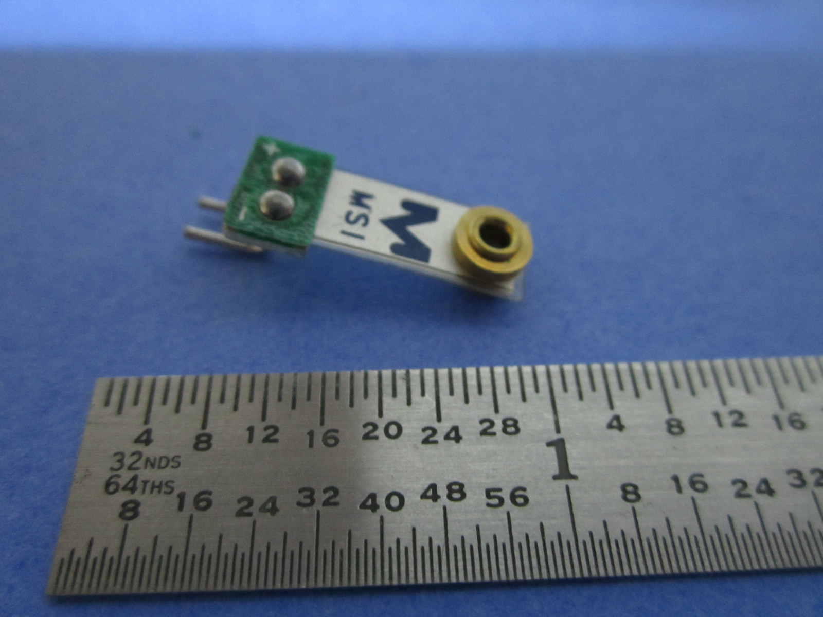

How about a high-sensitivity piezoelectric accelerometer (about1V/g) as the sensor ?
Should some changes be done in the 'Leak2' circuit if i use an accelerometer?
Also how do i include an Anti-clipping circuit to protect hearing ?
I have never played with and have never seen a datasheet for an accelerator sensor.
My latest RC model airplane is stabilized by three of them and they do the job very well.
You can clip the earphones signal to limit the loudness or use an AGC (automatic-gain-control) circuit.

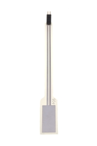

You need a vibration sensor, not an air microphone.
Look in Google for Piezo Contact Microphone. Many links show how to attach a piezo transducer.
Double-sided tape is used to fasten it on this You Tube video which shows it on the body of an acoustic guitar, a drawer, a comb and on the guy's forehead. It shows the schematic of a Jfet high input impedance preamp:
