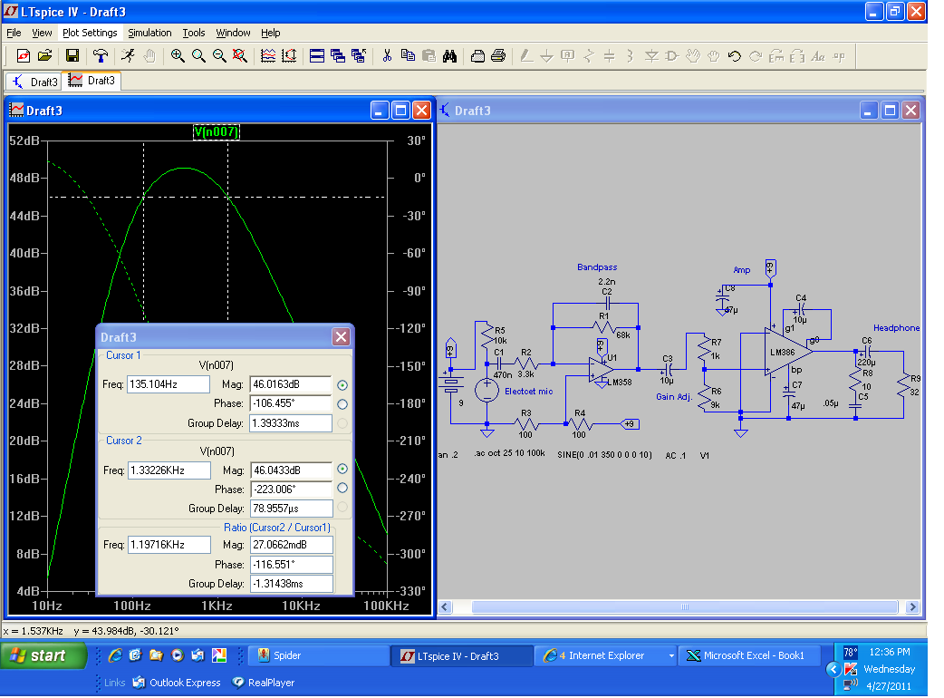

Leak Amp
Here is one I think will work. It uses the electret mic idea. I think you can get the parts at Radio Shack. It has very high gain so watch your ears.
R6 and R7 represent a pot to adjust the sensitivity. The center (wiper goes to the amp)
You will need to google the data-sheets to get the pins for the ICs.
An LM358 opamp has too much hissss to be used as a mic preamp with high gain. It will sound like a leak all the time.
Use a low noise audio opamp instead.
The LM386 amplifier also has a fairly high hisss level when its gain is 200 so reduce its gain to 20. Then use a second low noise audio opamp for more gain of have the preamp provide more gain.
The inverting opamp has a low input impedance that loads down the electret mic and has gain that is much lower than you think. So use a non-inverting opamp preamp with an input impedance of 20k to 100k ohms.
Amplifier
How about a TL071?
What would you recommend?
I think what you mean is the mic has an output impedance of 10K (the supply resistor) so like a 3x reduction?
How about a TL071?
A TL071 is inexpensive so its noise level is not as low as a better more expensive opamp like an OPA134. But it has much less noise than a lousy old LM358.
The minimum supply for a TL071 is 7V but I have powered many from a 9V battery and they worked fine when the battery dropped to 6V.
A TL072 is a dual inexpensive low noise opamp. Each one can have a gain of 20 and the LM386 amp can also have a gain of 20. Then the total gain is 8000 which is plenty.
I measured an electret mic output impedance to be 4.7k ohms. In parallel with the 10k resistor that powers it its total impedance is 3.2k ohms. If it feeds an inverting opamp that has a 3.3k ohms input resistor then the level from the mic is reduced to about half and the gain of the opamp is about half of what you think. Then the output level is 1/4 of what is needed.

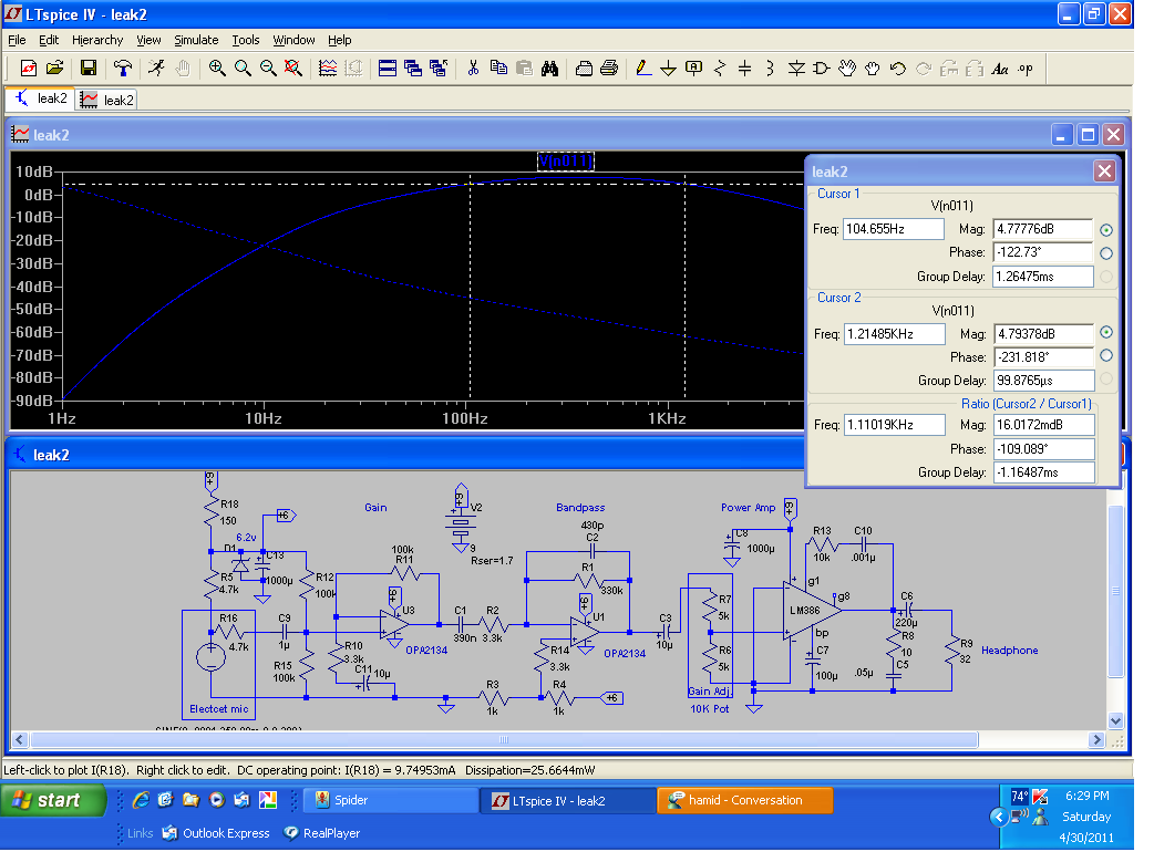

Leak2
Here is another shot with some better amplifiers and some more testing. I'll send you a PM with e-mail if you would like me to send you a parts list you can order from mouser in the US.
