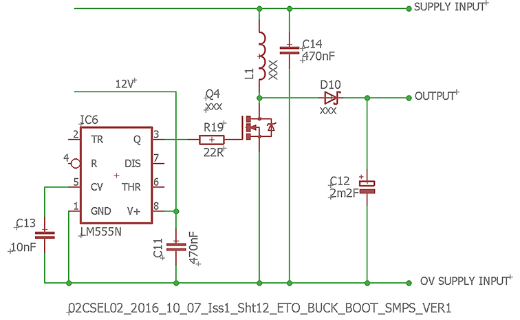

Hey...
I m trying to simulate the ckt which I got from Google....
There is so many problems​

Hi Amey,
Below is a part schematic showing the components in your original circuit re arranged.
The additional capacitors are decouplers: don't be tempted to omit then because they are essential for reliable and predictable operation of the circuit.
I have no idea what the input voltage is because you haven't said so there may be problems with the 555 12V supply line.
The output diode would work better if it were a high speed Schottky type.
I haven't completed the design or analyzed the pulse width modulation function or the feedback control; I thought you may like to experiment.:)
spec
