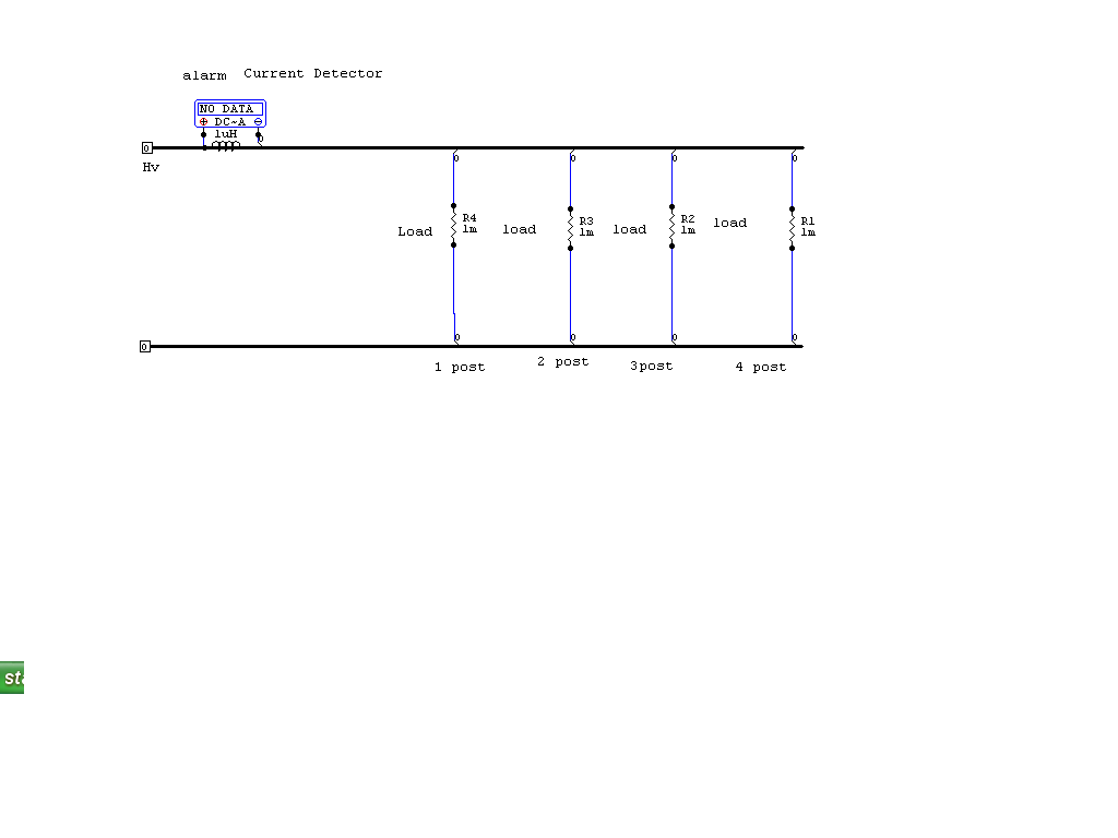

here's my idea, untitled.PNG ,if the wire is cut the total resistance will change,the current will change too. you need current detector
that produce alarm signal when the current is change.
Broken wire detetection
Hi jumides,
that doesn't solve my problem. I want the entire wire divided into many sections to be able to tell the exact position of the interruption.
Also keep in mind: I was talking about HV (high voltage of approximately 15 to 20KV)
Nevertheless, thanks for your idea.
Boncuk

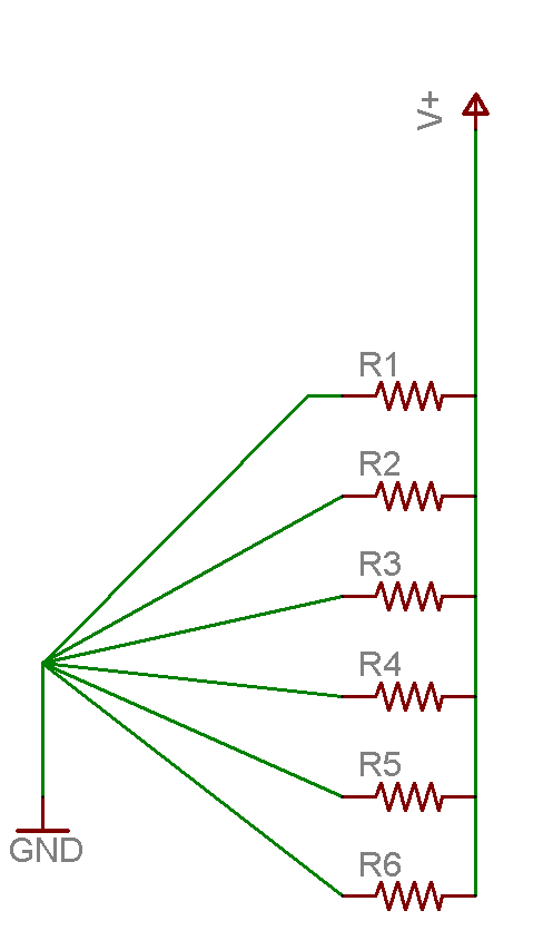

Let me just throw out another idea. It could detect and locate two cuts easily, but not more. Of course, the plan you have to monitor each segment could detect more cuts, but might be more complicated.
Someone earlier suggested a resistence network, such as shown below. The wire could be connected to ground at many places and from the total resistance to ground at the source, one could calculate which segment was cut.
What if instead of resistance, one looked at capacitance, and instead of using ground as the reference, simply used a twisted pair? In other words, the uninsulated live wire would be twisted with an insulated wire.
As an experiment, I took a partially used roll of telephone (CAT 3) wire. It was initially 250 ft, but I had used quite a bit of it. The capacitance between one pair was 2.16 nF. I removed 8 ft and the resulting capacitance was 2.00 nF (i.e., 0.02 nF per foot). That would allow me to estimate the remaining length at about 100 ft, which is about what it looks like.
In practice, if the current to the hot wire drops (or any other factor you may monitor) indicating a cut, one could immediately measure capacitaance from each end and determine the location of the cut or cuts in distance from the source. Of course, the capacitance measurement could be made by a variety of means; I simply used a meter for this experiment. If the high voltage is pulsed, you could get a measure of it continuously. John
