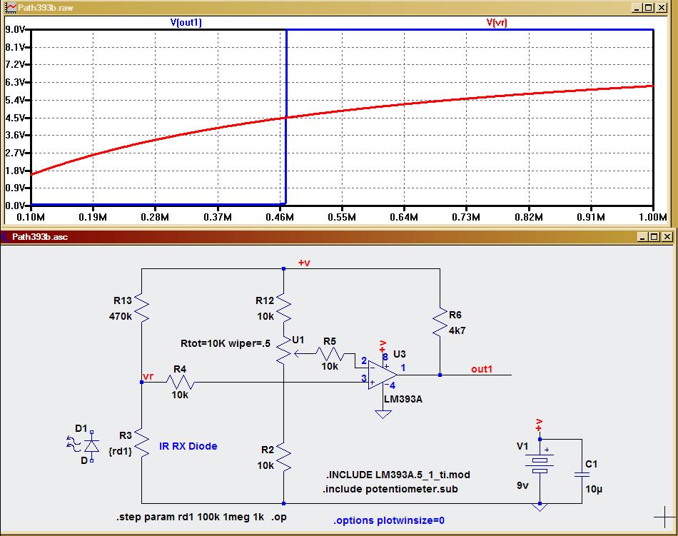

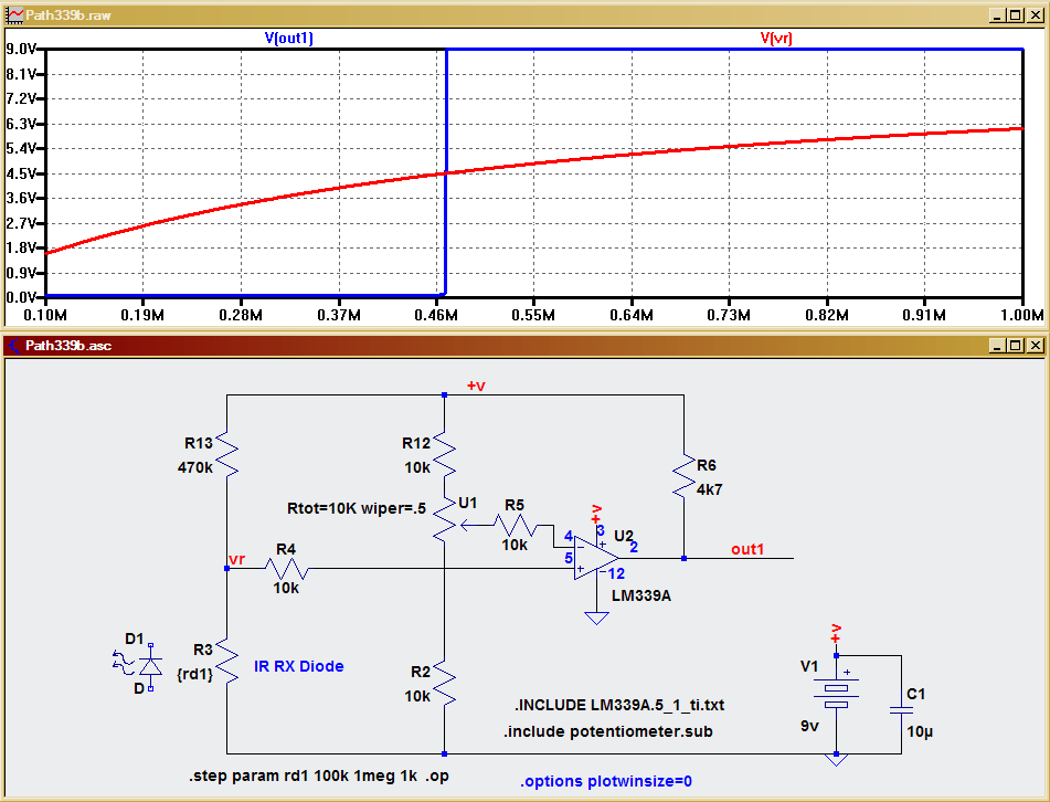

I have a rough idea what you have connected up, I will produce a circuit diagram.
Are you able to build a circuit like this.?
If so we can expand the circuit as required, this was done using LTSpice in simulation.
The output is LOW when the IR receiver is detecting the TX IR.
Note: I have shown the pin numbers for a LM393, if you want to proceed let me know.
EDIT:
Showing the LM339 version.

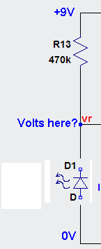

OK,
I need a little more from you.
Connect the IR receiver diode and a 100k or 470k in series [as shown ] in circuit, apply 9V to the free end of the resistor and 0V to the detector Anode [as shown]
Measure the voltage across the diode , when lit and dark,,, let me know.

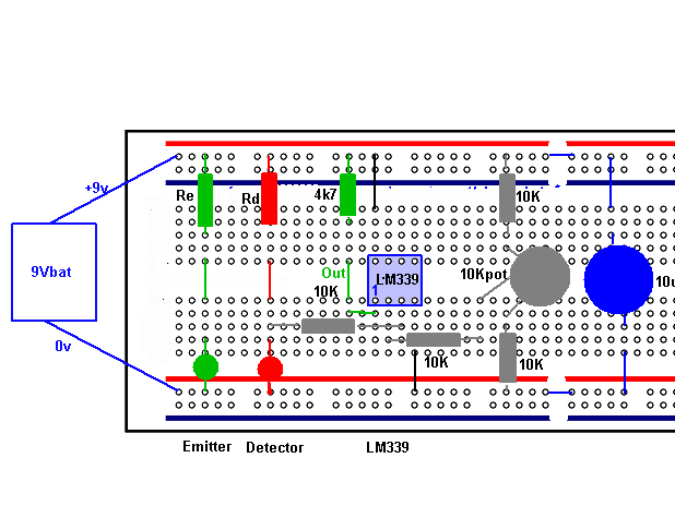

Looking at your diagram I will post a pictorial view of the project board, you have gone a little OTT with your batteries.:D

From your pic of the diodes your not using a 'IR receiver' but a simple detector diode.
hi ds,
Look at this option.
