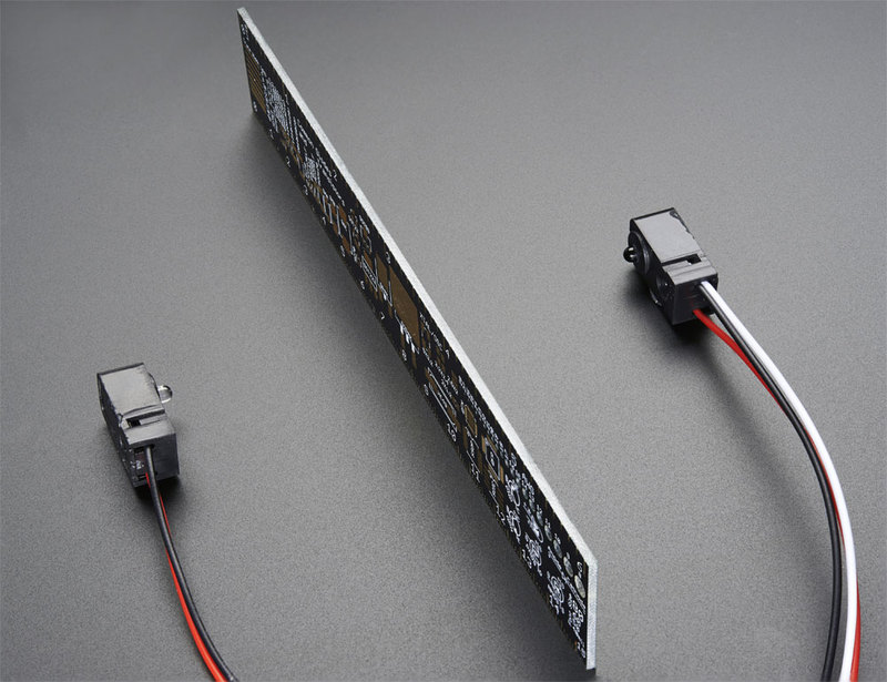

I am a college student doing hobby project, I need to design an IR bream break detector which would work with IR Transmitter and IR Receiver to detect beam break between transmitter and receiver in 1 meter range. Can you please suggest components and circuits for same, preferably requiring 5V. The functionality should not get affected in ambient lighting as well. I will be connecting this to Arduino MC

There are lots of articles available using a 38kHz receiver module with an Arduino. One example.
It sounds like you need to generate the signal with another circuit as the AGC on the reciever modules mean they have to have a pulsing signal (500mS as well as 38kHz).
You could easily get started with just a module, an Arduino and any remote.
Note, television remotes all work at over a meter distance.

I think that if you can align a phototransistor with a cheap laser diode 1 meter away, you would not need more than a cardboard shield to keep the ambient light from swamping out the phototransistor. Should be very easy once you get everything aligned. Run a reasonably high current through the laser diode (check the specifications if available) and put a moderate load on the photo transistor - adjust the photo transistor load for the right sensitivity and away you go!
If ambient is very strong you can modulate (pulse) the laser diode with a couple kHz square wave and then detect the light with a frequency selective amplifier and then detect the couple kHz square wave with a simple diode detector. See U.S. patent 6831628B1 https://patents.google.com/patent/US6831628B1/en?oq=us6831628B1 for an illustration of the square wave amplifier and detector system.
I like Dick's suggestion. I have played with some very inexpensive LASER diodes from Amazon and the mating sensors. Lazer diodes 30 pieces for about $13 USD. You can get fewer for less cost. You can get 5 LASER diode sensors for about $10 USD. While the LASER diodes are rated for 5.0 volts I suggest with 5 volts applied use a 47 Ohm resistor in series with the diodes. I have not tried them in bright daylight but for cost these combinations may be worth a try.
