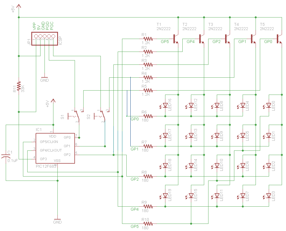

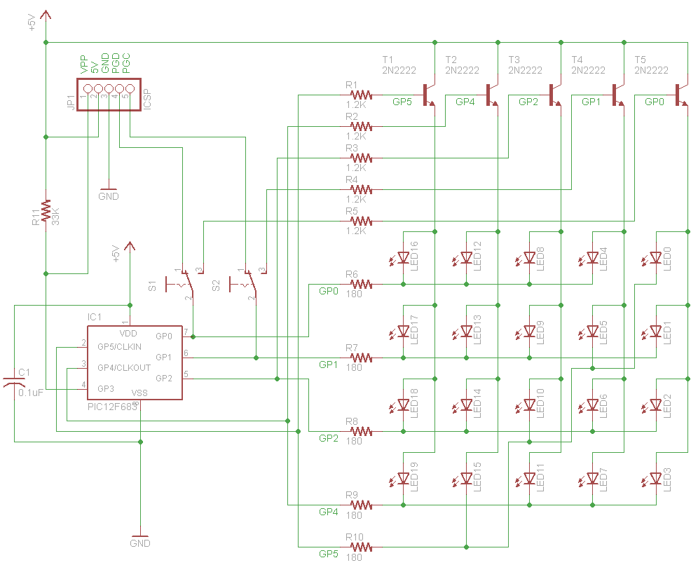

Here's my version of the schematic. If you want to use GP3 as an input and still be able to use ICSP then you'll have to add a third switch (or some other means of isolation) to switch between VPP use and input use.
Whether the connections to R6 and R7 be changed to after the programming switch? It would help in-situ programming, not to have load on the chip pins. The schematic after suggested mod is attached.
Yes, I thought of that. Already had it wired the other way though, and didn't feel like changing it. Anyway, it works perfect as is, without that change. I'm lazily soldering one together. Guess I'll make that change on the soldered one.

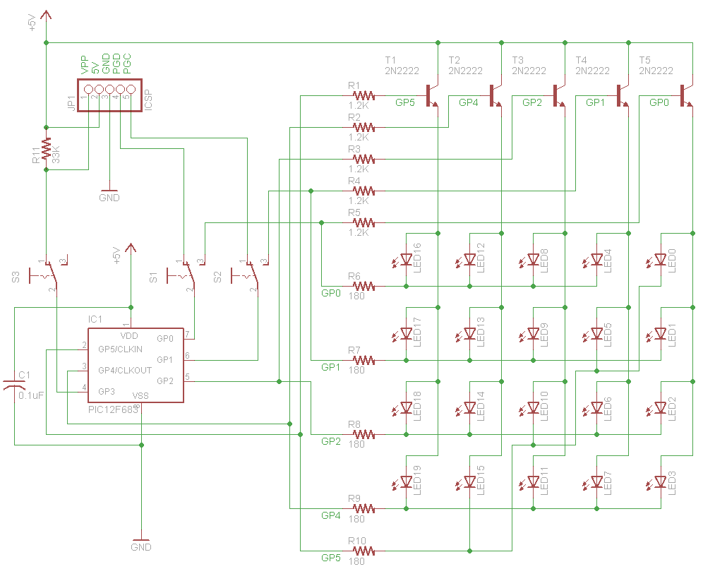

Here it is, Mr. Sarma. :D Added the third switch as well, so that one last input pin can be used.
Nice Futz, ultimate as all pins are now free for use. Great job.

You probably could have done away with the switch on GP3. I just added a push button "mode" switch onto my board at GP3 with a pull-up resistor. You can also potentially use GP3 for bit-banged serial receive.
Mike
Those PCB mounted slide switches look great. May I ask about Manufacturer, Part Number, Source, please?
They are Digikey part# EG1903-ND. That's a Canadian link. For US link, click here.
Those switches work great on breadboards too.
True. Could rig a single tact switch to control all three lines. Just hold down to program.
I don't understand.
You wouldn't need a slide switch at all for GP3 because that would be connected to a normally open push button switch.
How would you connect a single push button switch to disconnect GP0/ICSPDAT and GP1/ICSPCLK from the LED circuitry when you push it and hold it down?
