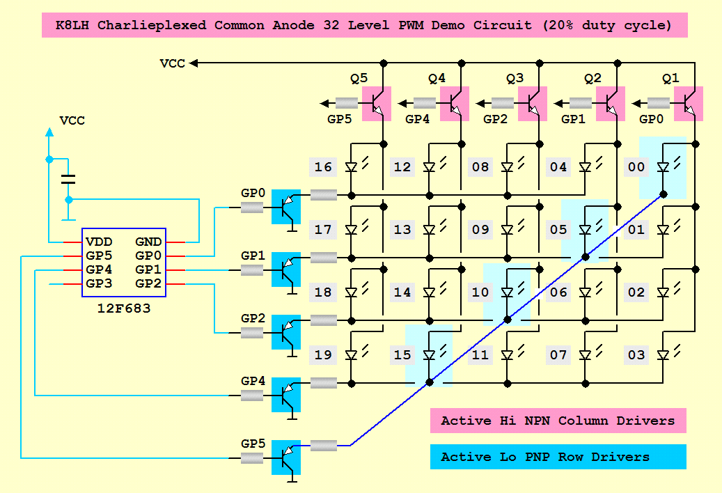

Transistors are 2N3904 NPN. Most people see that they're sourcing drivers and assume they're PNP (because the drawing is so fuzzy).
I used 2N2222A's with 1.2K base resistors.
and 20 ohm current limiting resistors on the rows
I've got 330's on the rows. Too much, but they were there and I wanted to start out safe.
Guess I'll go over the whole thing and trace every wire again. Sigh... :p

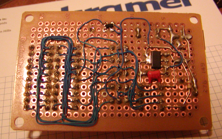

Nice design Sir ...I like it very much....
May I hack your hardware design? but not the code :)
Also can you show the underneath of your board Sir if you don't mind?
Hi Gayan,
I'm not sure what you mean by "hack my design".
Attached is picture of bottom of board. It contains one surface mount PNP row driver transistor on GP0 (an experiment to increase peak current from 20 ma to around 50 ma).
Mike

What's confusing about the schematic? Is it the dark blue diagonal "floating" row line?
The schematic isn't so bad I guess. I was just generally confused, but I'm starting to get my head around it now. Mostly I'm relieved that it was working all along and I didn't do some weird random screwup. :p
