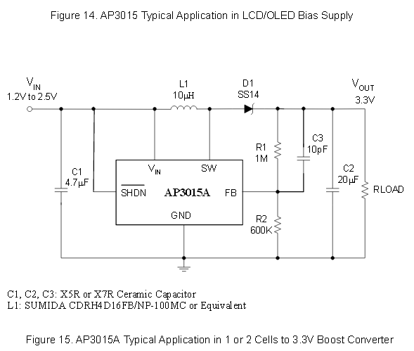

hello everyone, I am trying to design a boost dc-dc converter to step up my 1.5V voltage from a thermoelectric generator to 12V. I have tried to look at several circuit designs such as using a mosfet with an inductor or using a BJT with an inductor, but I am worried that I am not getting results. please help on how I can best do this. Thanks

Most important spec you forgot to state is how much load current it must supply. But to answer your question: it is very easy to boost 1.5V to 12V, I have published app circuits for it. The easiest way is to use a free running 555C and coil with a 12V zener diode.

Look at the AP3015A. In the data sheet they show two examples. 1.2V to 2.5V in 3.3V out and another circuit with 20V out. The current is low.

???? I never said it was a single part solution. You use a three cent external transistor (2N3904) as the coil's switch device driven by the output of the C555.
Like I said: if the user would post the load current the 12V line has to supply, I could say whether this solution is feasible. It is a working circuit (published) for relatively low power applications. With 1.5 VIN, it can put out 12V at a couple of milli amps.
