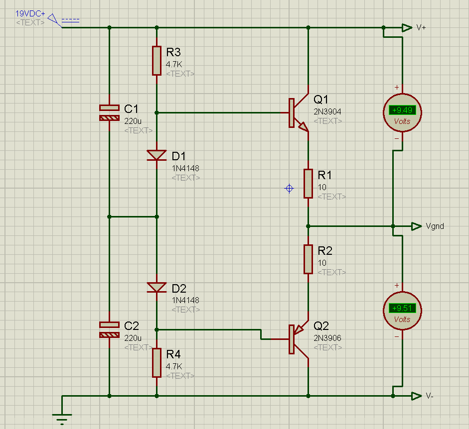

Do you think its reasonable to split the 19VDC supply to feed the preamp with virtual +9.5 0 -9.5V? . Then to tie line level signal to the power amp using the gnd ( which is the -9.5V in the preamp?). Using a coupling capacitor. The AF of interest is < 5Khz.
Active splitter:
You did not show the schematic of your NE5532 preamp.
ANY audio opamp circuit with a split supply can be easily biased then use a single-polarity supply. Then its ground is the same ground as the power amp ground.

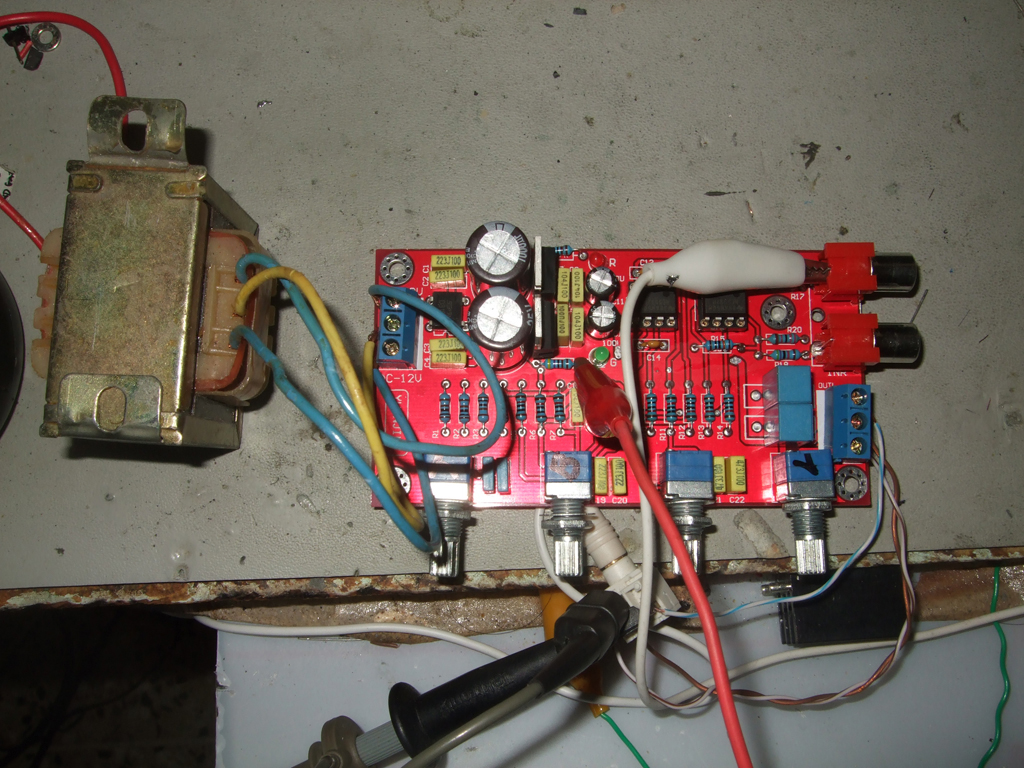

I don't have the NE5532 schematic as the Ebay preamp item comes assembled. I could try to decipher one channel using continuity checks as all parts are thru hole. Should I do that so you can advise me better? The pic is the preamp I have, it carries tone controls.
The Chinese circuit has a horrible translation. It has NO specifications.
Try your voltage splitting circuit with it.

Edit: having done some more research, it seems there are good reasons for leaving the split supply as is. Perhaps the better approach is to use 2 isolated supplies , a dc blocking cap and tie the 'grounds' together to let the preamp drive the power amp.

The preamp using the OPA2134 can use a single-ended supply if the opamps are biased at half the supply voltage and use capacitor-coupling.
